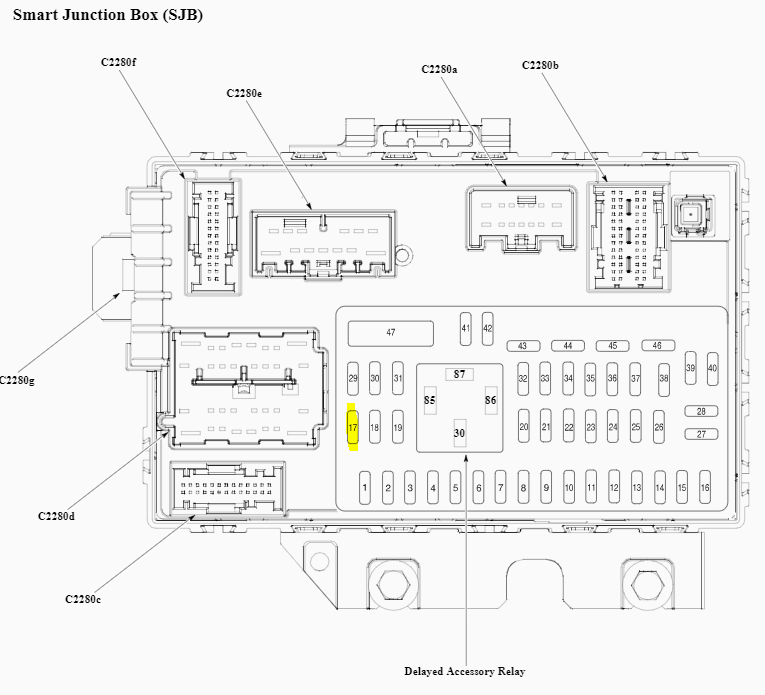

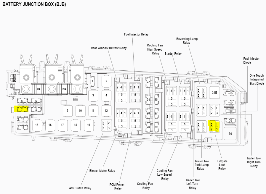

Ok I was wrong I don't see instructions for a manual release for the lift gate, usually ford puts a little removable trim panel that if you remove and mechanically release the latch.

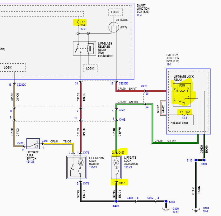

I highlighted all the fuses and relays related that can be replaced if you want to try and replace them first, but based on what youve said they should all be fine.

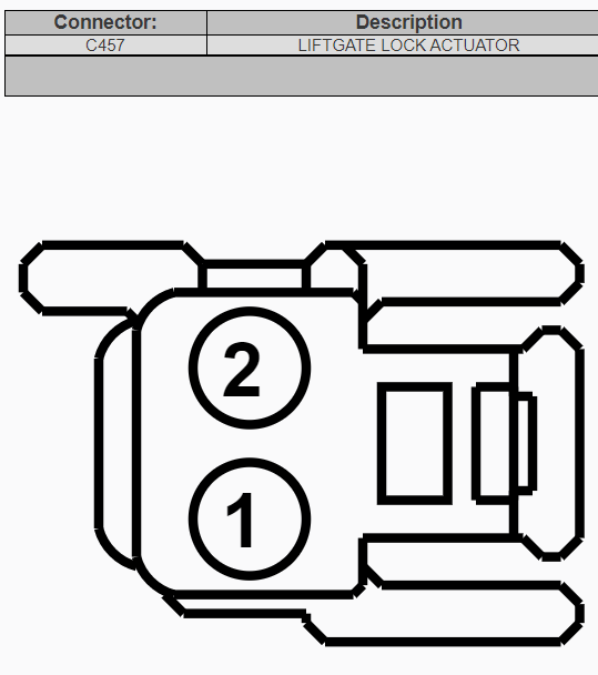

What I would do it remove the liftgate interior panel and disconnect the liftgate latch connector and check if it receives 12V when the unlock and liftgate release button is pressed.

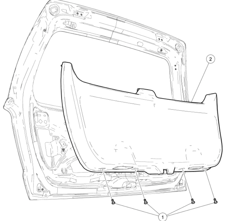

Honestly Im not sure how to get the liftgate open if the latch wont release since I dont see a manual release, there are four screws in the button that I dont think you can access with the liftgate closed.
You might be able to pull the top part off and and get your hand on the latch to force it to release. Of course you do risk damaging the trim panel doing this but Ive had to do similar on other vehicles and as long as you dont bend the trim panel down to much it was fine.
