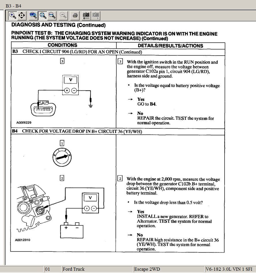

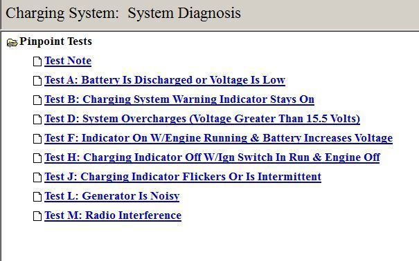

Pinpoint-B shown above. Pinpoint-ALL.pdf attached below.
