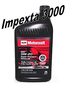

Hi guys,
I've been buying engine oil from dealership and i was wondering if it was:
- Regular oil
-Semi synthetic
-Full Synthetic.
I've attached an image of what it looks like exactly.
no where it say synthetic on the container.
Thanks
Danny
Old Dec 8, 2017 | 03:12 AM
What does your vehicle owner's manual recommend?
Most of the time you can put a better grade of engine oil into the vehicle with no or very little problems. The problems generally come when a lesser grade is used. Exhaustive testing is done by the engine manufacturer before recommending a particular grade/type of oil. Out in the field we learn why the recommended oil is used . Some engines are manufactured differently and until we see the results of not using what is recommended , possible problems appear that can be avoided using what is recommended, or better, grades of oil. Today's engines are manufactured with very close tolerances and a thinner oil is usually recommended
Some manufacturers earlier started out with recommending a synthetic blend while others went to full synthetic. Most of the time newer grades are backward compatible, OK to use in older engines,but older grades are not suitable for newer engines. Manufacturers are always looking to keep the cost of ownership lower than the competition , where a full synthetic is fine, but costs more and if a synthetic blend was OK and less expensive ,that was the recommendation.

That says "super premium " so it's not marked synthetic blend and it's not marked full synthetic so it's regular oil . It's ok as long as its the recommended viscosity .
