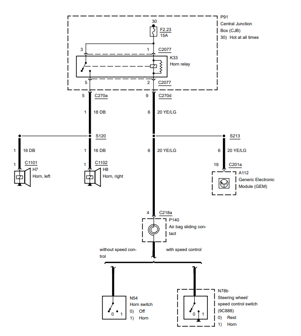

Here is the wiring diagram you can use. Its a very basic system. Switch controls relay, relay controls horns.

Now that you have the diagram, you might just take each part that could provide a ground to the relay and remove them from the circuit one at a time and you may get your answer.
hmm, I am not sure how basic that is, to me, but thanks. 😀
Great approach, thanks.
