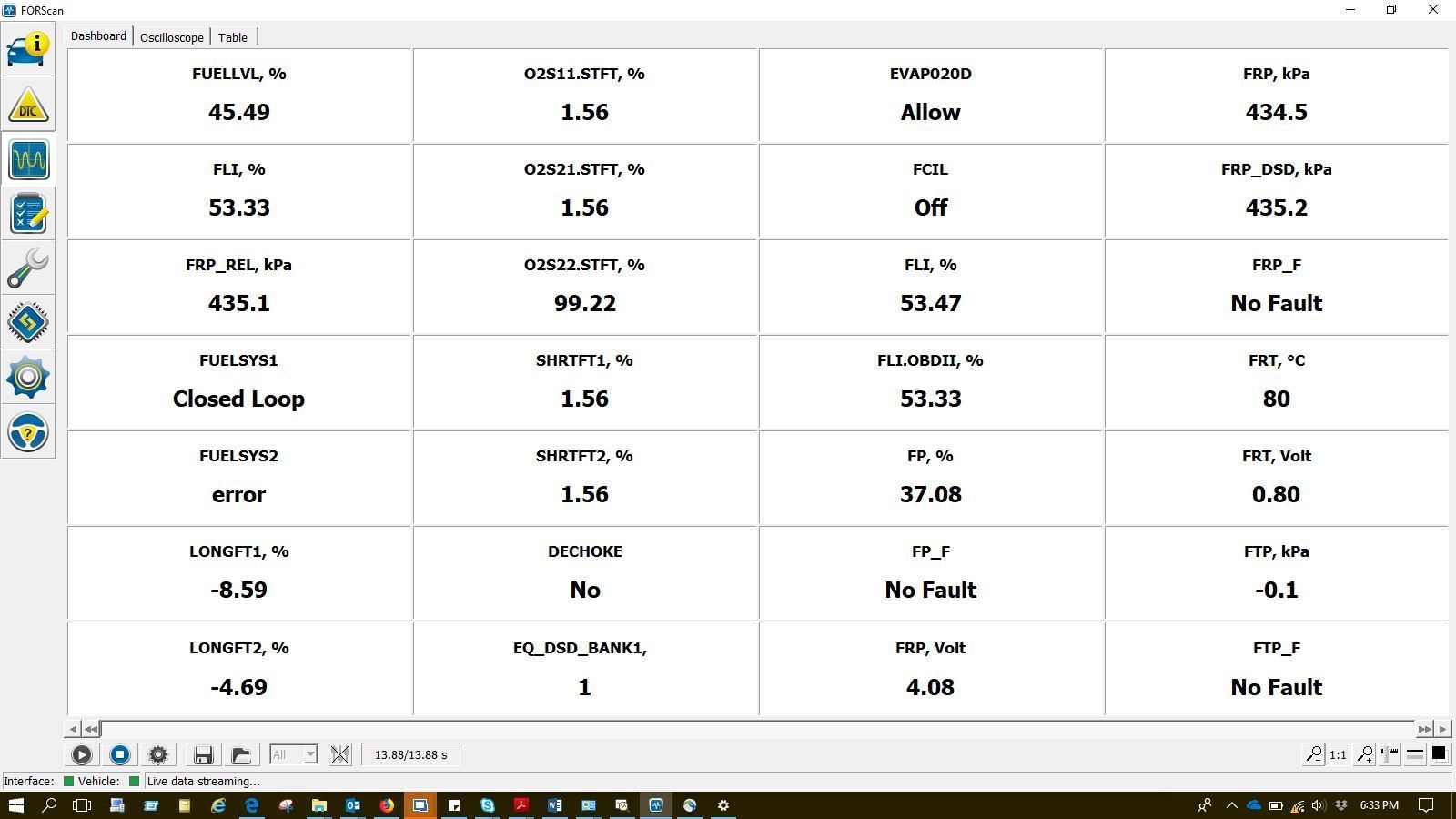

Secondly, I have an OBDLink MX wifi along with ForScan. Could you direct me on what paramaeters you want me to capture that could help with this case?
Thanks again.

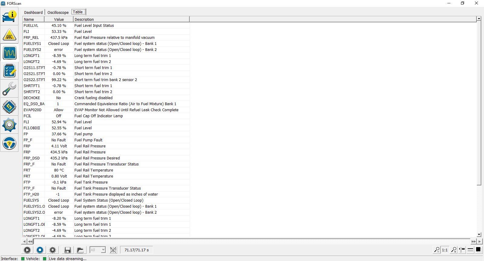

Hello Hanky,
I have attached some of the files here for you to see. I have also decided to buy a replacement Fuel pump Driver Module. I would place the order on Amazon.
Kindly see the photos below and text attached

The info supplied is incomplete, however, I would not purchase that fuel pump driver module just yet because There seems to be a problem with the oxygen sensor for bank 2 which is the bank facing the front of the vehicle. There appears to be no signal supplied and the sensor after the converter is working overtime. If we could see the voltages for the o2 sensors that would be more helpful. There is a good possibility the o2 sensor is disconnected or malfunctioning. There could also be a potential problem with the catalytic converter which might be responsible for the power loss . Can we get those voltage readings ?
