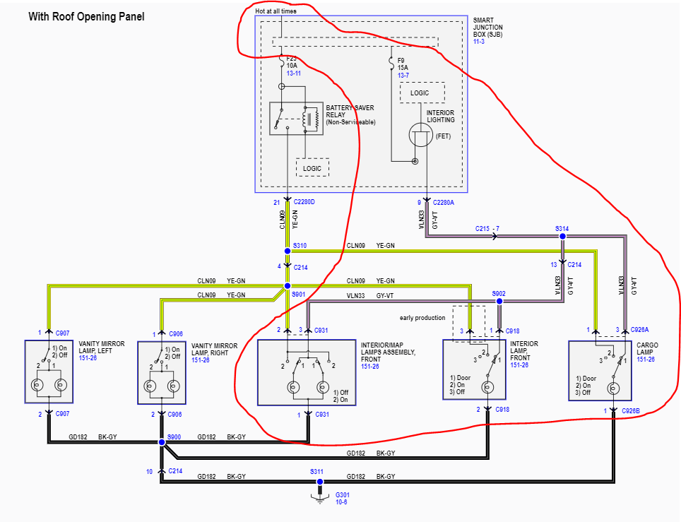

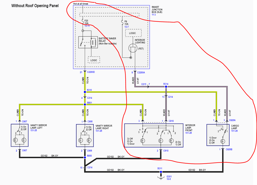

OK so the wiring depends on if you have a sunroof or not. Here is both wiring diagrams, it is controlled by a processor in the SJB which I believe looks at what position the light switch is and what position the doors are in.
Based on the wiring diagrams the overhead light with three positions - Off, On, & Door. I seem to recall there being a little button next to the light that you push to turn it on. Keep in mind there is a dimmer switch to the left of the steering wheel, I wouldnt be surprised if this dimmer switch plays a part into it.
