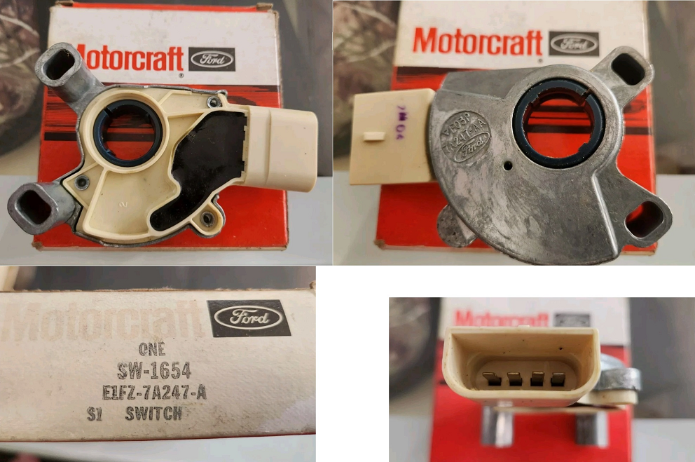

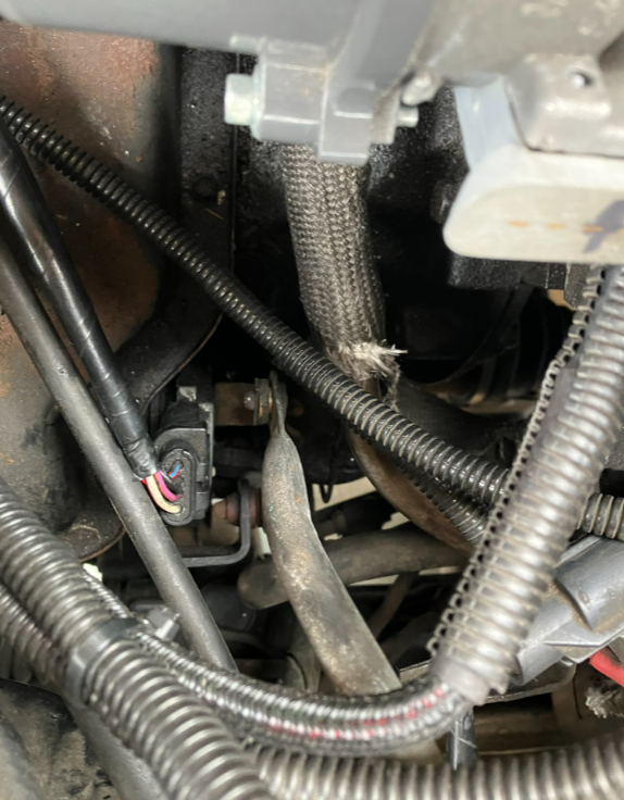

The one my my '88 Escort GL (3-spd autoTX) is suspect, and I've found a replacement for it. Not hard to see, not really that hard to get to, but it is in a tight spot (with TX linkage around it).

This same switch (and variants) are used on a LOT of Ford products; several videos that I have watched show an index mark. This early switch has no marks, that I am aware of.
I will add that accessing, and removing the switch, can only be done with the gear selector in "Low" so that the linkage uncovers access to the 6mm bolt heads.

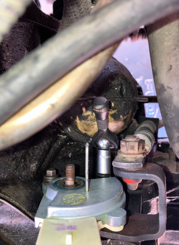

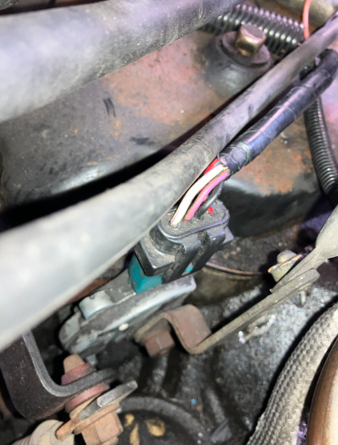

Just "seeing" the switch, end on, is near impossilble. Getting a 8mm socket onto the two 6mm bolts (at the bottom of the switch) is going to take some extra work. The first photo was taken with my endoscopic attachment.

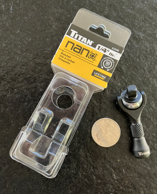

I think this might do the trick; 2" swivel-head. I also picked a couple of short 1/4" drive "wobble" extensions.

It DID do the trick. I had to R&R the tranmission linkage, and some wires and hoses to get to it, but once that was out of the way it was clear sailing.
It turns out that the switch itself was not the problem; the actual issue was that the two 6mm x 40mm hex bolts that secure the switch housing to the face of the transaxle were only finger-tight, which allowed the switch to rotate everso slightly out of position. I removed the old switch, it tested good, electrically. But I replaced it anyway.
The small hole, in the face of the switch, allows a 3/32" [.093"] drill bit to be inserted to 'lock' the internal switch to the external housing for installation (eliminating one possible alignment error during installation). It's removed after installion.
