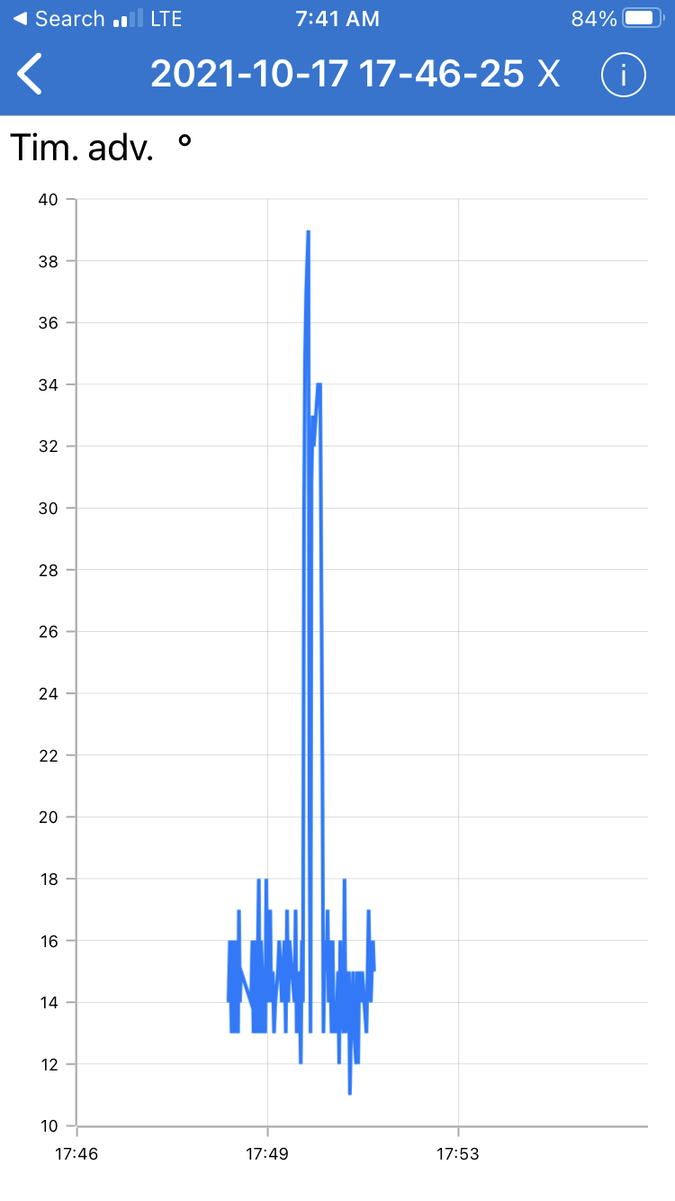

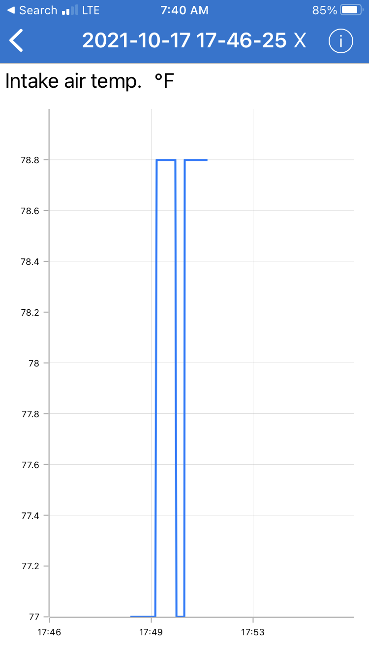

Default Data Recording
Hi,
Attached are a few screen shots I took of my last drive cycle. I can only view 2 functions at a time so I tried to group systems that functioned together as closely as possible. The only thing that really caught my attention was the Fuel Pressure kPA and the MAF g/sec. They seem very sporadic. However, I’m not sure exactly how to read these charts or at what intervals it’s measuring. Hope this might help..
