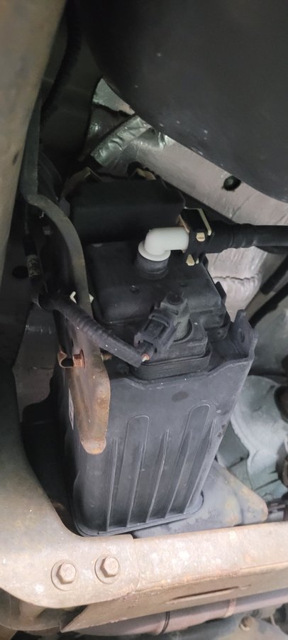

On YouTube video they show the fuel filter in front of the gas tank on the frame rail.
All I see is the gas lines going into a black box in front of the gas tank. See picture.
Is the fuel filter in the black box or is it apart of the fuel pump?
Thank you

Do you have the new filter ? If not , get it first, so you know what you are looking for.
You will require a release tool to get the lines off. It is usually mounted on the chassis frame rail above where the driver seat is located.
The fuel line has high pressure that must be relieved or you will get a fuel bath.
Make sure you know the correct procedure before starting to remove the filter.
Use gloves because today's gasoline is not good to get on your skin. Contains Benzene not good at all !
