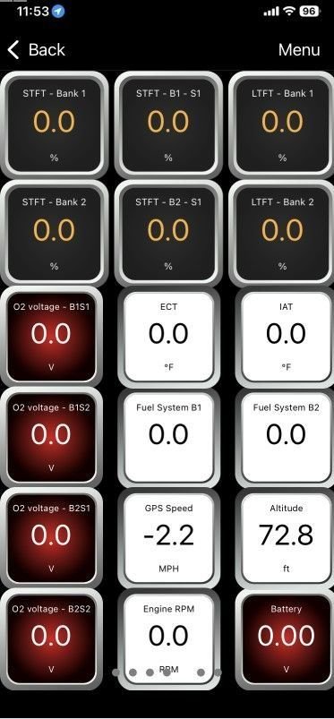

For scan tool here is the option:
1) if you have a laptop you can download Forscan and run the free trial, you will need to buy OBDLink EX (recommended) a cheap $17 OBD2 to USB ELM327 (not recommended)
2) if you prefer bluetooth adapter get OBDLink MX+ (this one is costly but it's top of the line with free enhanced diagnostics support, you can read ford's specific DTCs), the bad thing about adapters is the lack of bi-directional support
3) Foxwell NT510 Elite w/ Ford, this is the best possible scanner you can get at just $100 with bi-directional support and active tests. It comes with one software (the car's make), each additional for around $70. When you get w/ Ford it covers Lincoln and Mercury, Honda software also include Acura, Toyota you also get Scion and Lexus.
4) Innova 5610, if you own many cars and with different car's make (ford, toyota, chevy, nissan, and a honda), then this scanner supports all make but with limited and basic bi-directional support but feature wise nt510 elite + ford software is way better than this. Another weakness of innova 5610 is the lack of support on European vehicles. This scanner is $300, exact 3 times more than NT510 Elite.
The easiest to get data stream is with a bluetooth adapter you can take screenshot of something like this:
Using the cable on a laptop you still can take screenshot. NT510 Elite and Innova 5610 you can still print to a wireless printer or you just need to take screenshots with your phone.
