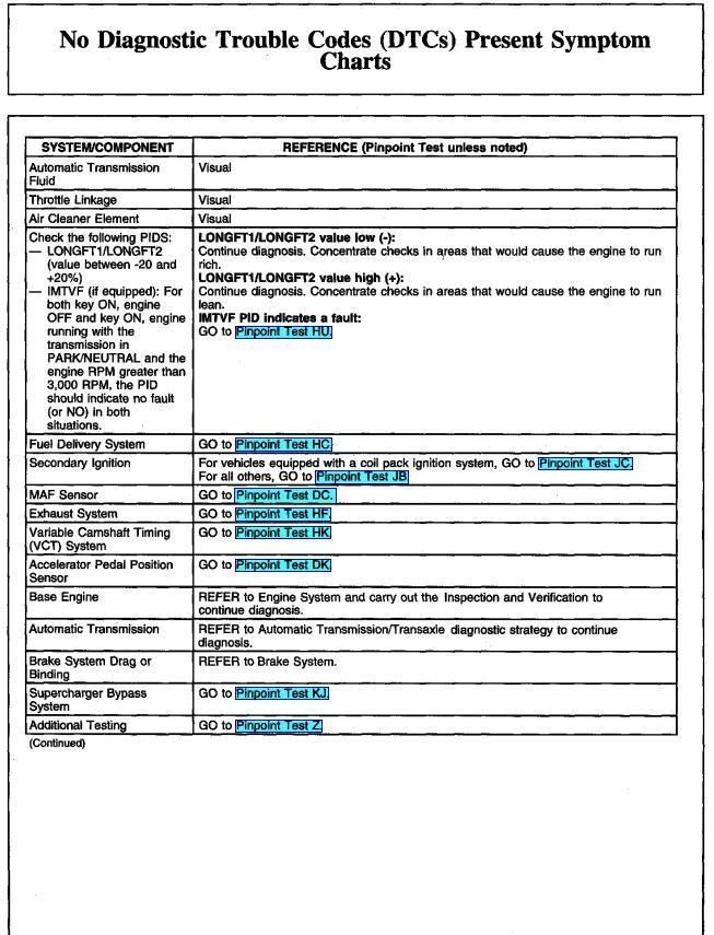

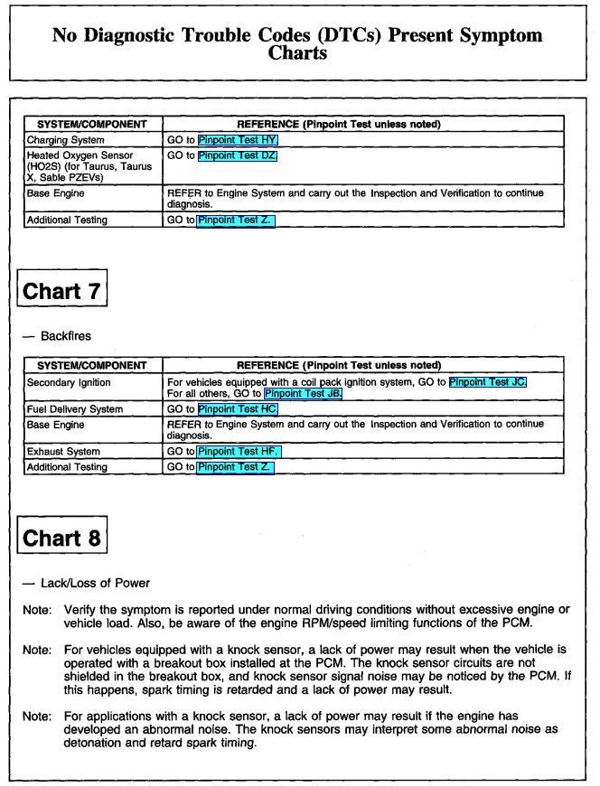

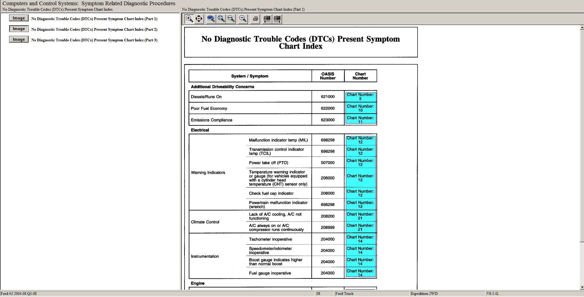

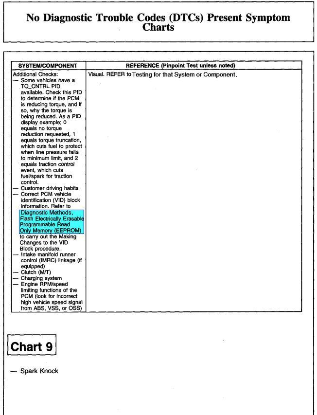

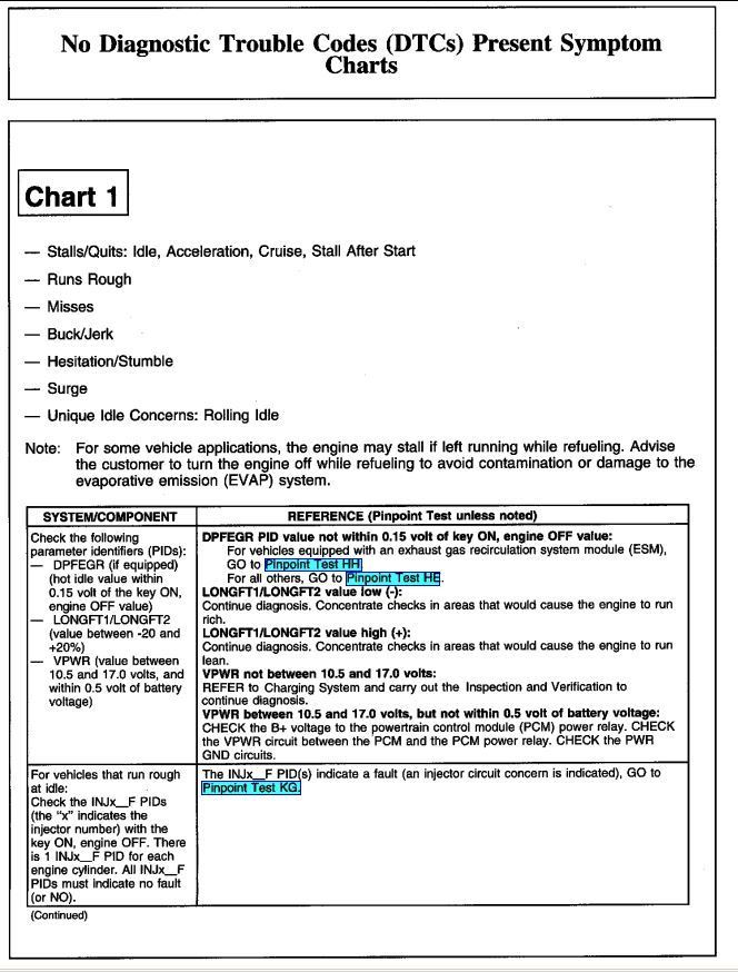

Driveability concerns so here's Chart 1 and 8.
Do you need to see any other chart? Which pinpoint test do you need.
