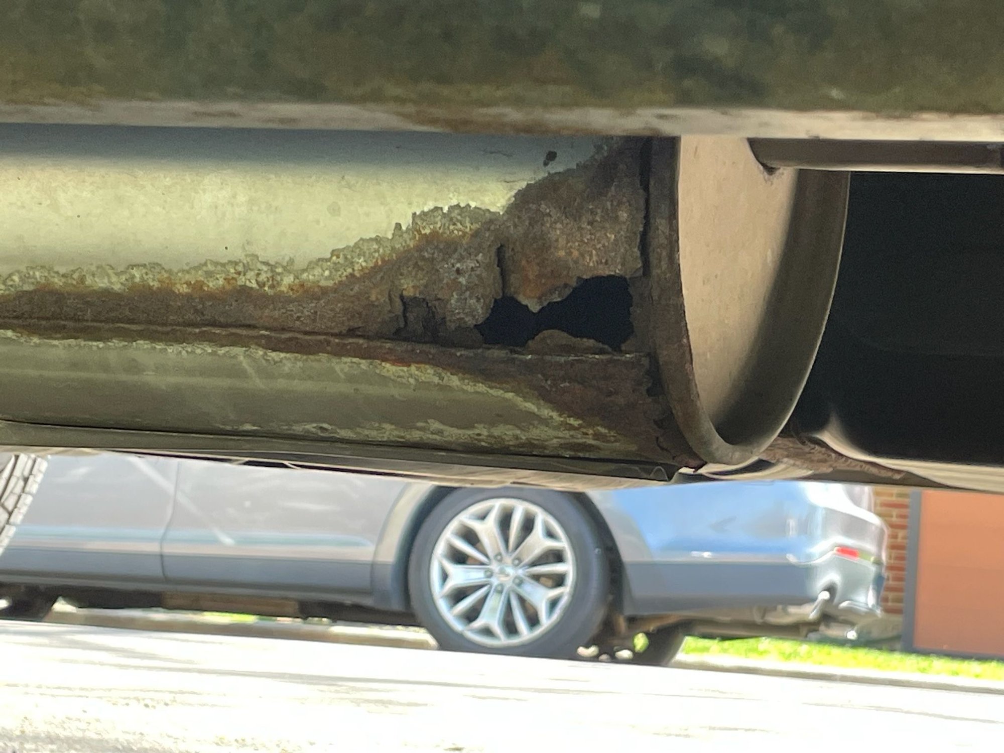

Hanky, sorry for late response. Been busy with work... But before trying this i decided to install a new throttle body mounting gasket. Which i did. I decided to take a look under the truck as it was running a Lil loud. I was correct. Found a nice Lil whole on my muffler. Now I doubt this will cause my current issue. But I now have something else I need to fix. Lol.
Odly enough the truck finally threw me a code for P2097.
So now It looks like i have an issue at bank 1 and 2.... needless to say i think i may now have to either make my own smoke machine or buy. Needless to say, I'll keep you updated
