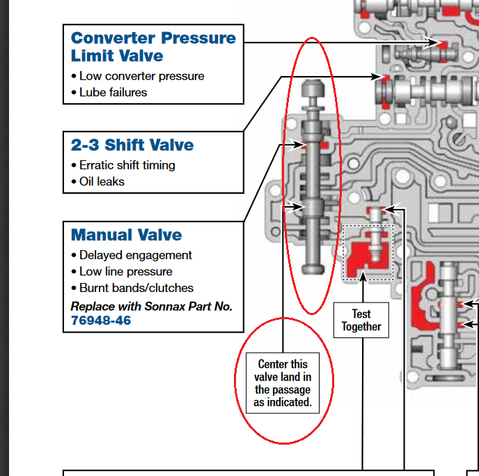

Today I put it all back together and noticed the symptom I described above. I suspect that the Manual Valve is not in the correct position and that is my whole problem, but I'm unsure. Per page 6 of the manual, the valve was to be placed a certain way:
Now, I realize that I didn't position that valve in any specific way. What I'm confused about is how the shifter makes a connection to that valve. Do I just move the valve a bit and expect the shifter assembly to move it around? Does it clip on somewhere?
When I removed the valve body, that valve didn't need to be disconnected to anything. It just came down.

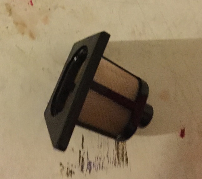

Also, I found this on the floor:
Where does that go?

Something you might check, And I know dropping the pan again is $#@!, but could the pin on the lever inside the trans that moves the manual control valve be indexed in the wrong slot?
Old Jul 5, 2018 | 05:59 PM
AboveTheLogic's Avatar
Joined: Jul 2018
Placing the shift tab into the groove of the manual valve did the trick. Didn't need to pull the valve body completely off. Just all but three bolts to get it to drop down enough to line things up. Drives fine now.
