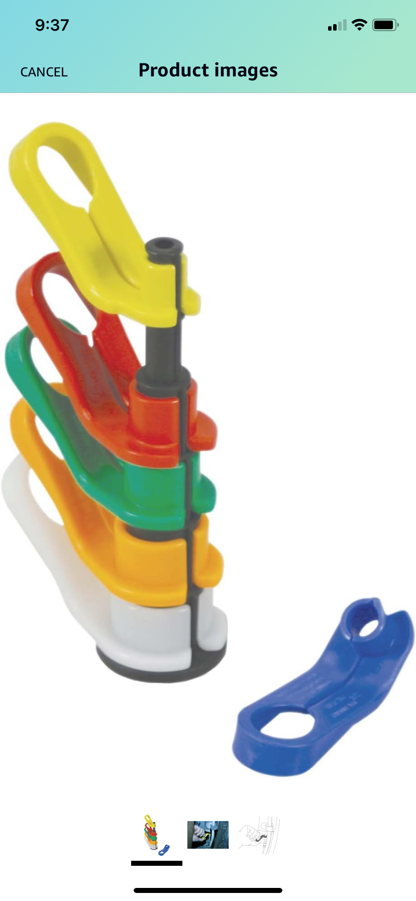

Did you need any special tools to disconnect it ?
Old Jan 2, 2024 | 08:43 AM
Nobounderies's Avatar
Joined: Feb 2021
Posts: 28
From: Charlotte, NC

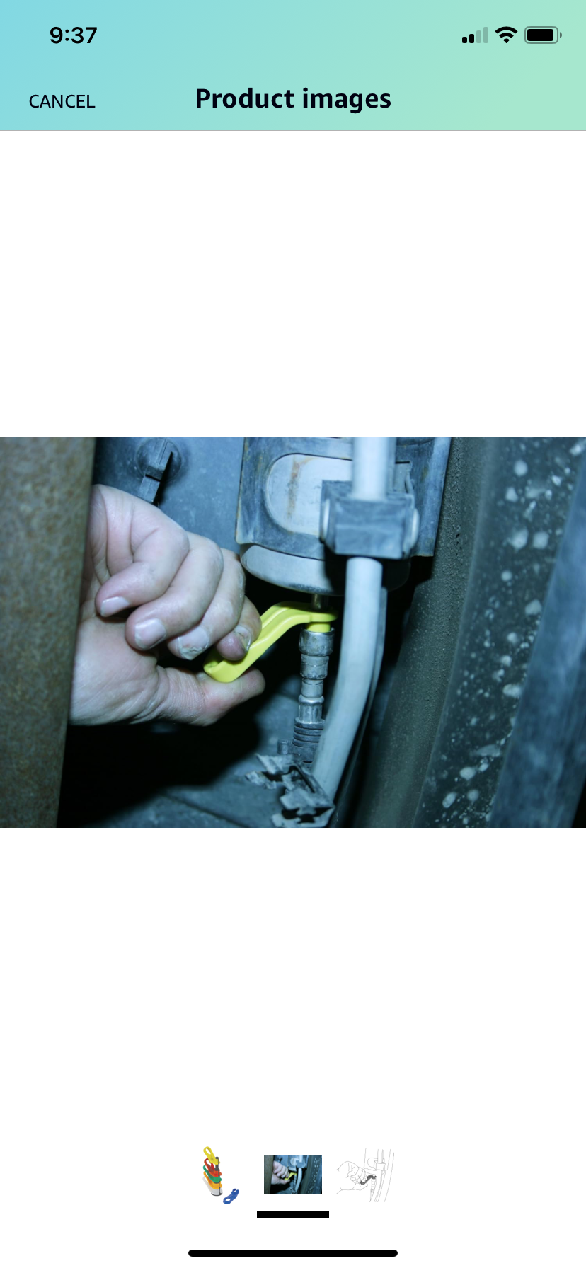

Yes, I needed an angled disconnect tool that I purchased on Amazon (see photo). I must say it was very difficult to remove because you have very little space to work with but it was a lot easier to install. I hope this helps.
Old Jan 2, 2024 | 01:03 PM
Spraying a little cleaner into the fitting, and blowing them out with compressed air along with some lite spray lube typically helps the fittings separation.
Good practice to remove the fuel relay and crank the engine, but bleeding off any residual pressure at the fuel rail shrader valve into container/large rag will help with an unwanted release at the fittings.
