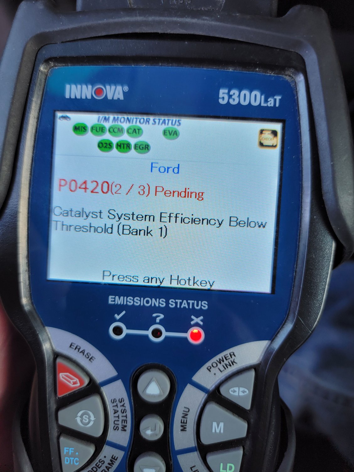

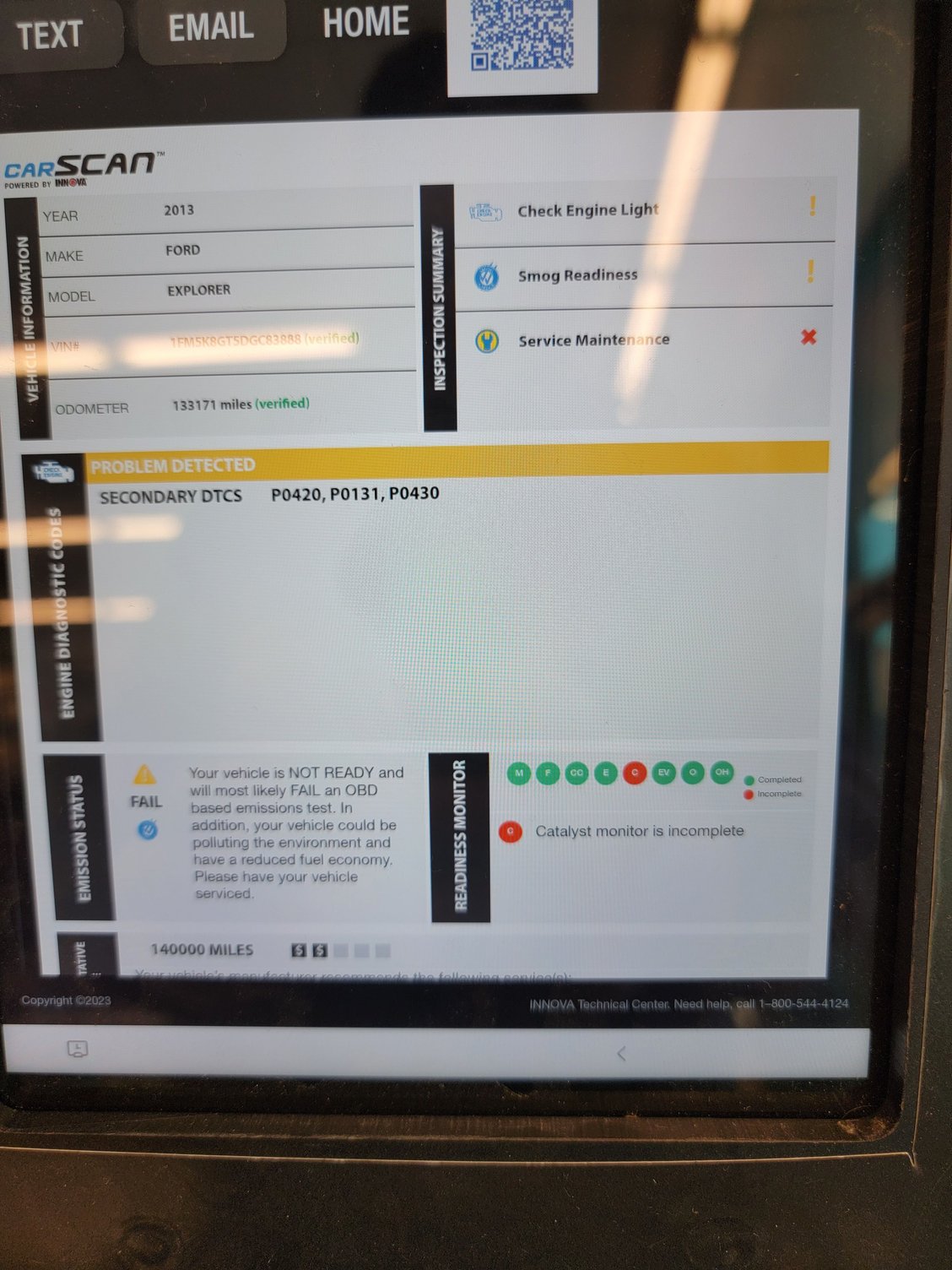

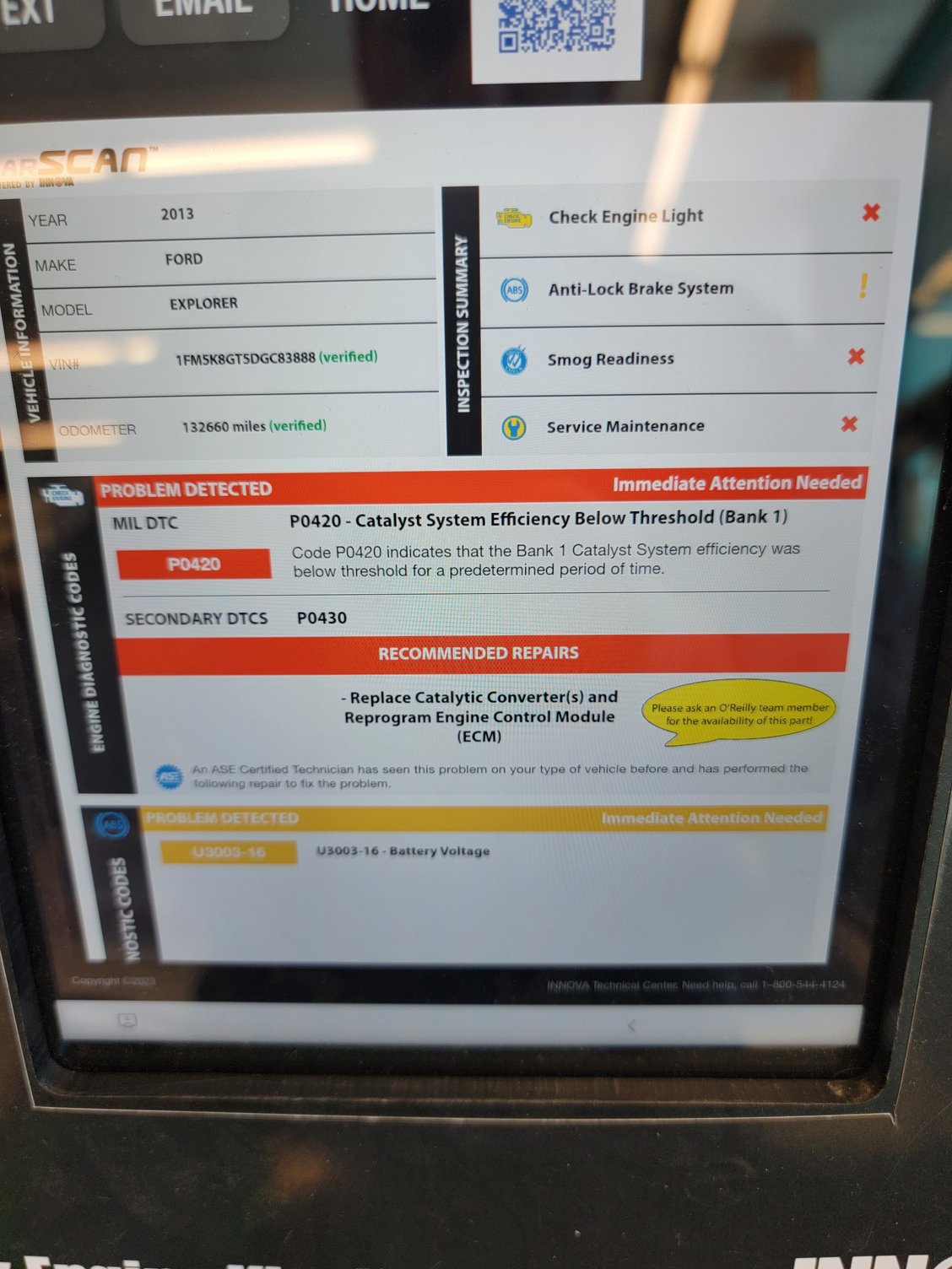

I got it home and sure enough, the check engine light came on. I brought it to the local O'Reilly's to check the code and sure enough, it was the P0420/P0430 codes. I also got a U-3003-16 code. The guy there said that it's not always the cats so have the O2 sensors after the cats checked too. I brought it to my local shop and he looked at the o2 sensors and they were black, so I had them replace them along with 2 lower ball joints and a rear wheel hub. The dealer I bought it from got his friend to cough up $500 to pay for the o2 sensors.

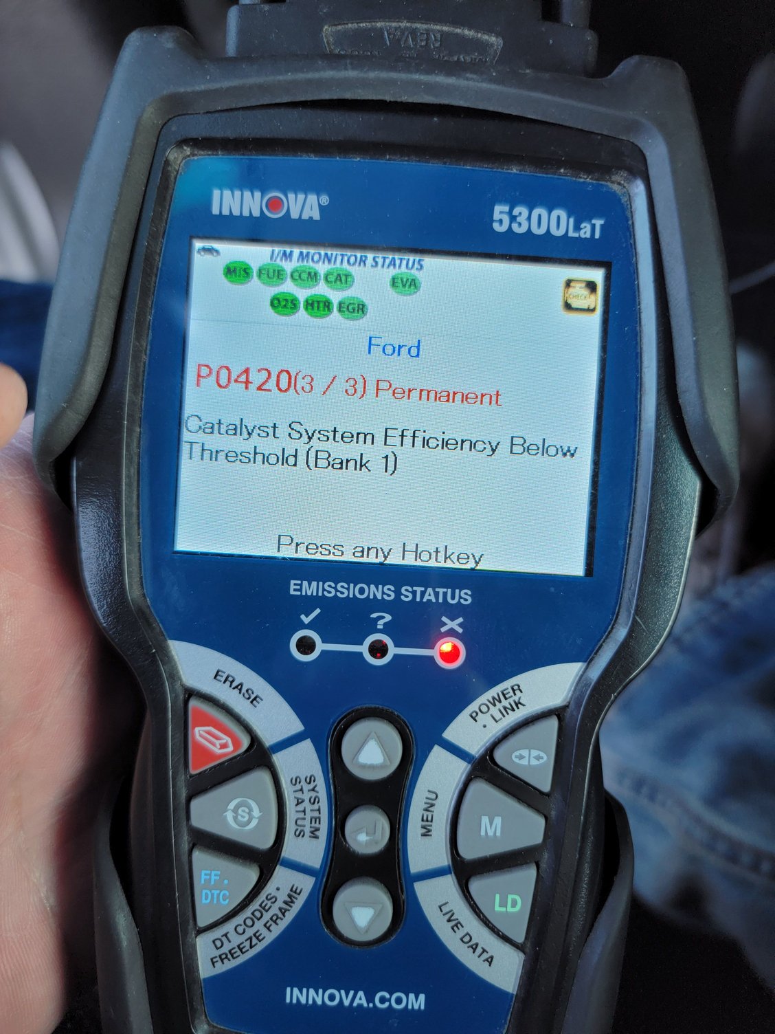

I left the shop with it (3 days later) and within 40 miles I had the check engine light again so I brought it back. It was throwing another P0420 code along with a P008A code this time. It seemed to be running fine, but we were confused. He reset it to see how long it would take to come back.
I drove up to St. Paul and sure enough the light came back on. I also noticed at this time that the vehicle had no power after 60 miles per hour. Hitting the gas, it would downshift, wind up and out, but not accelerate and didn't seem to want to shift to the next gear unless I got off the pedal. I could barely get it to 75mph (freeway).

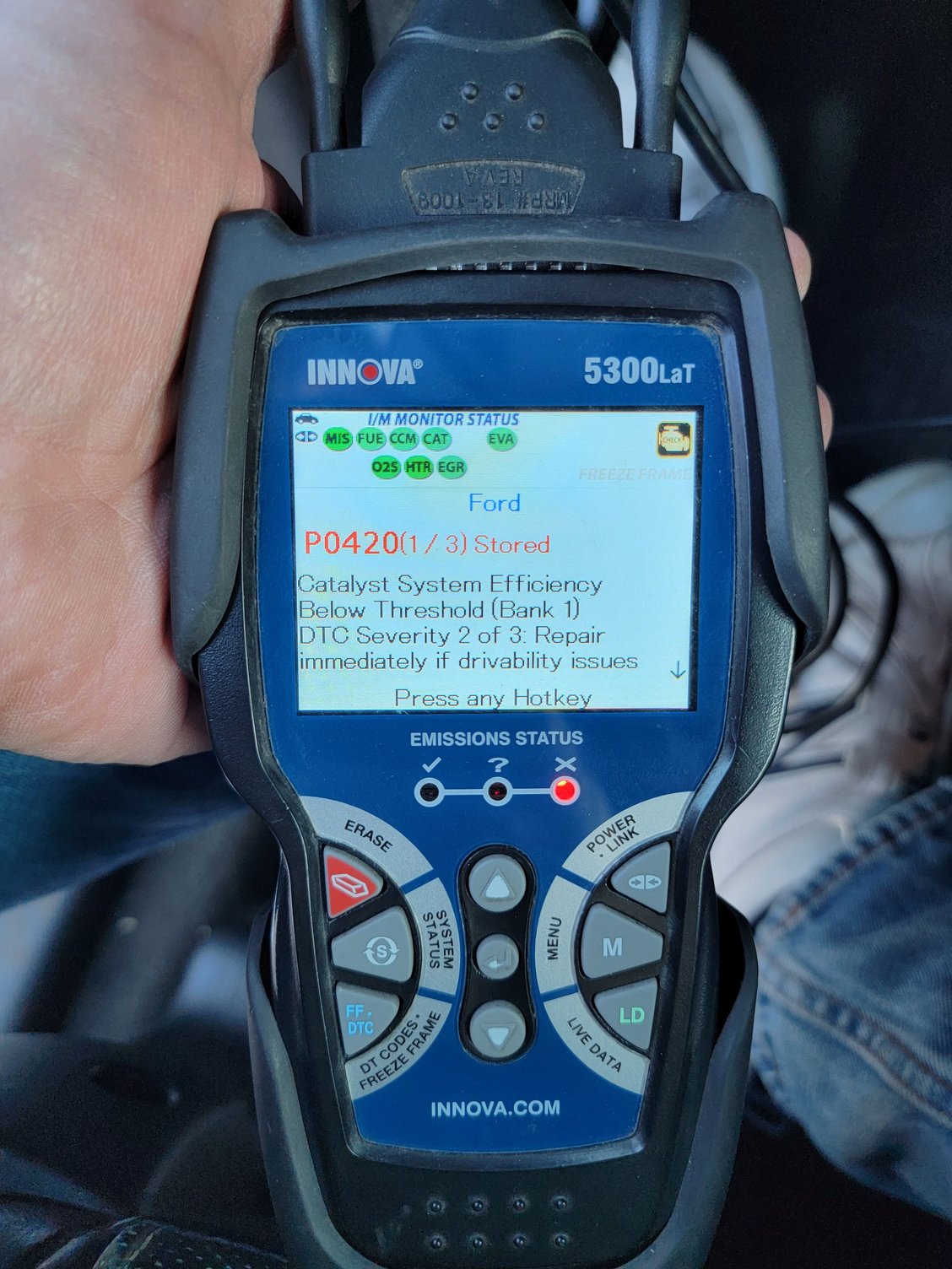

I checked the Check engine light again at an O'Reilly's in St Paul and it was the same code. I reset it and I drove back home.
Now today, the vehicle seems sluggish and doesn't accelerate for **** and NOW is throwing a bunch of white smoke out the tailpipes, but no check engine light and the temp gauge seems normal.

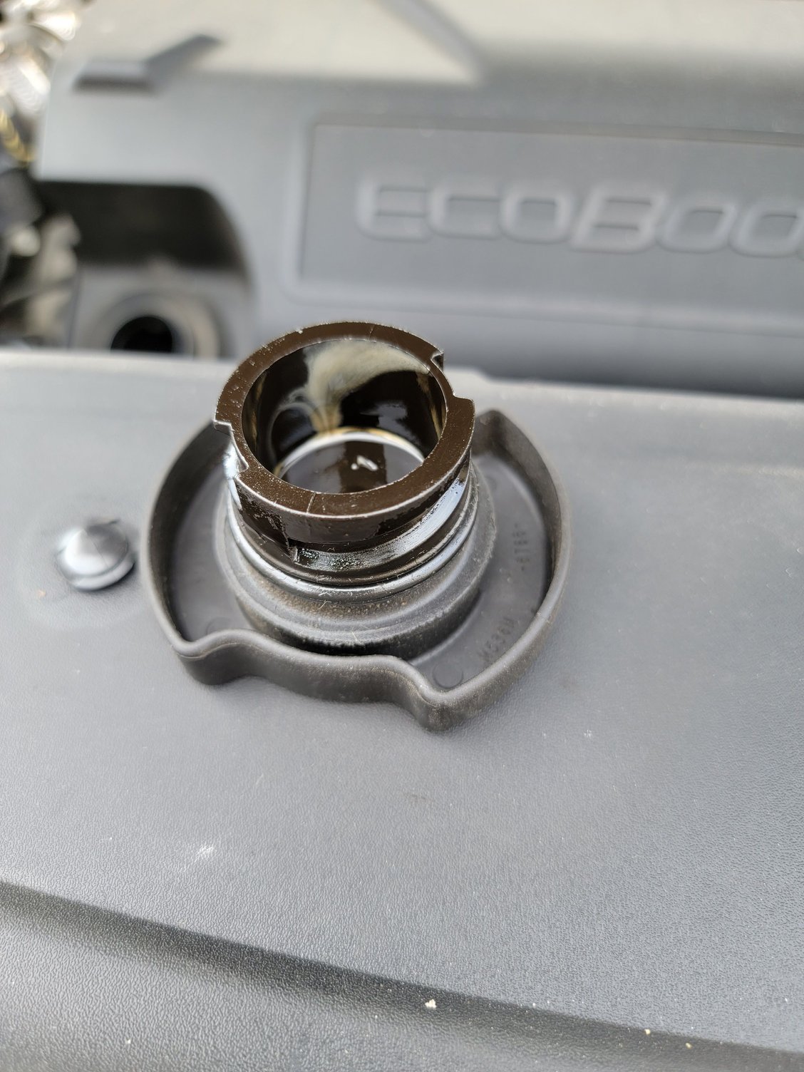

Well... I just went back out and checked and found this inside the oil cap, but there isn't anything on the dipstick

Well... it went to a Ford Dealership and found out that the bank 1 turbo blew apart and was sending oil through the catalytic converter. The system must have detected it because apparently it shut down the Turbos which is why I had no power. But I didn't get a check engine light for it.
The mastertech at Ford recommended replacing BOTH Turbos as well as both cats along with the intercooler.... $10k worth of work... on a vehicle I paid $14k on 2 weeks ago. To say i am livid is an understatement. The small dealership i bought it from now doesn't want to talk anymore. The Ford dealership is going to wait 30 days and contact the extended warranty place to see if they can at least get the bank 1 side turbo and cat covered as well as the intercooler since technically the turbo is part of this engine.
