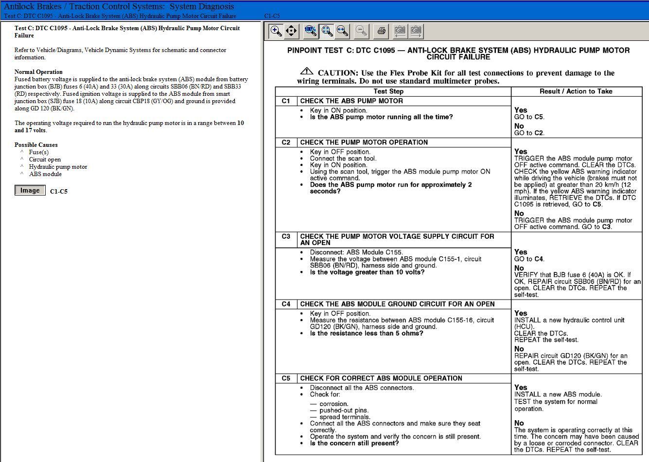

Your Ford Diagnostic scan.pdf shows that you have DTC C1095.
If you don't have a scan tool capable to follow this, no worry, just begin at C3 shown above.

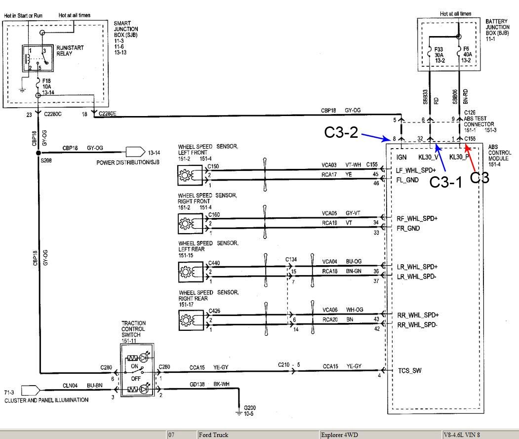

C3 (red arrow as shown above):
- engine off key out (because it's hot at all time)
- remove abs module connector

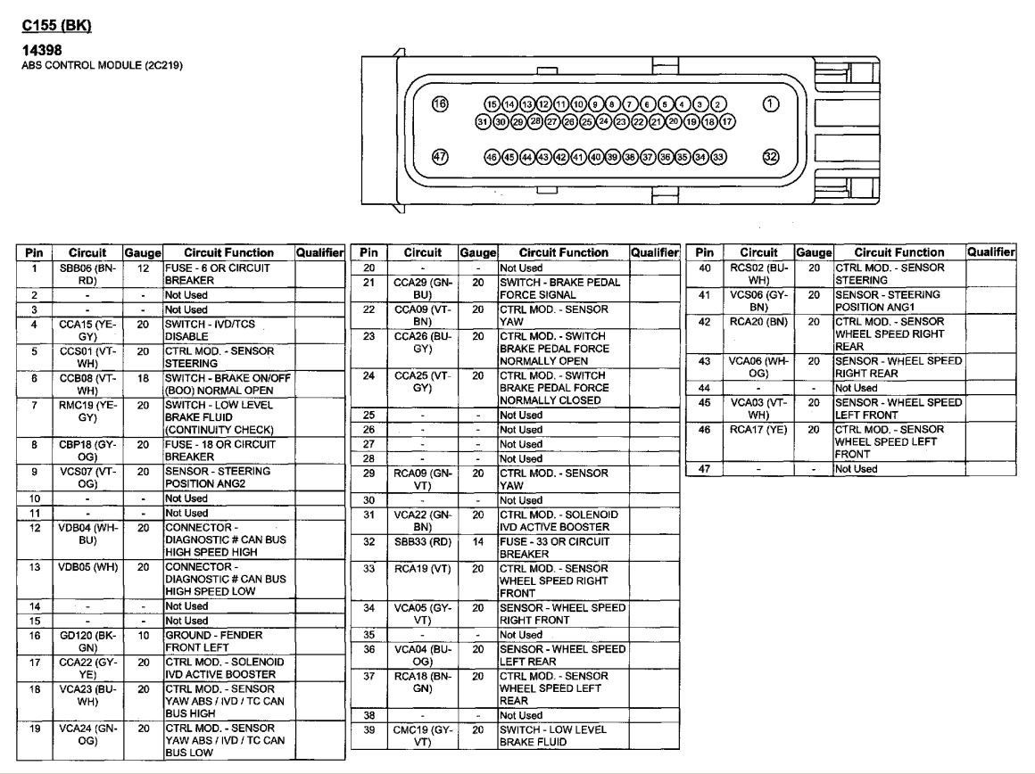

- voltmeter black to chassis ground
- voltmeter red to pin 1 on the connector you just removed
C3-1 (blue arrow above):
- my personal addition, while you are at it, just do the same measurement to pin 32 as well and you expect to receive the same battery voltage.
C3-2 (blue arrow above):
- same as C3 and C3-1, but this C3-2 requires your key to be in ON position and you expect the same battery voltage.
You know what to check if any of the 3 test receives 0 volt.

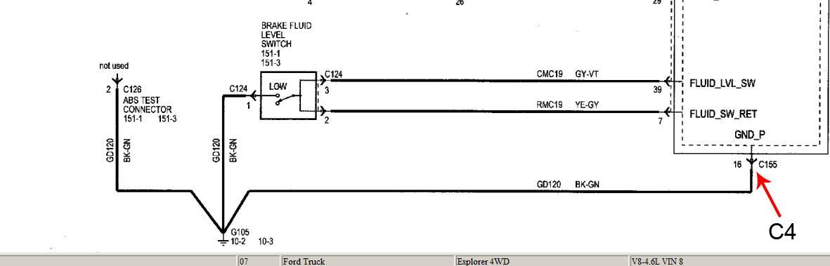

C4 (red arrow as shown below):
- ohmmeter black to chassis ground
- ohmmeter red to pin 16 on the connector you just removed

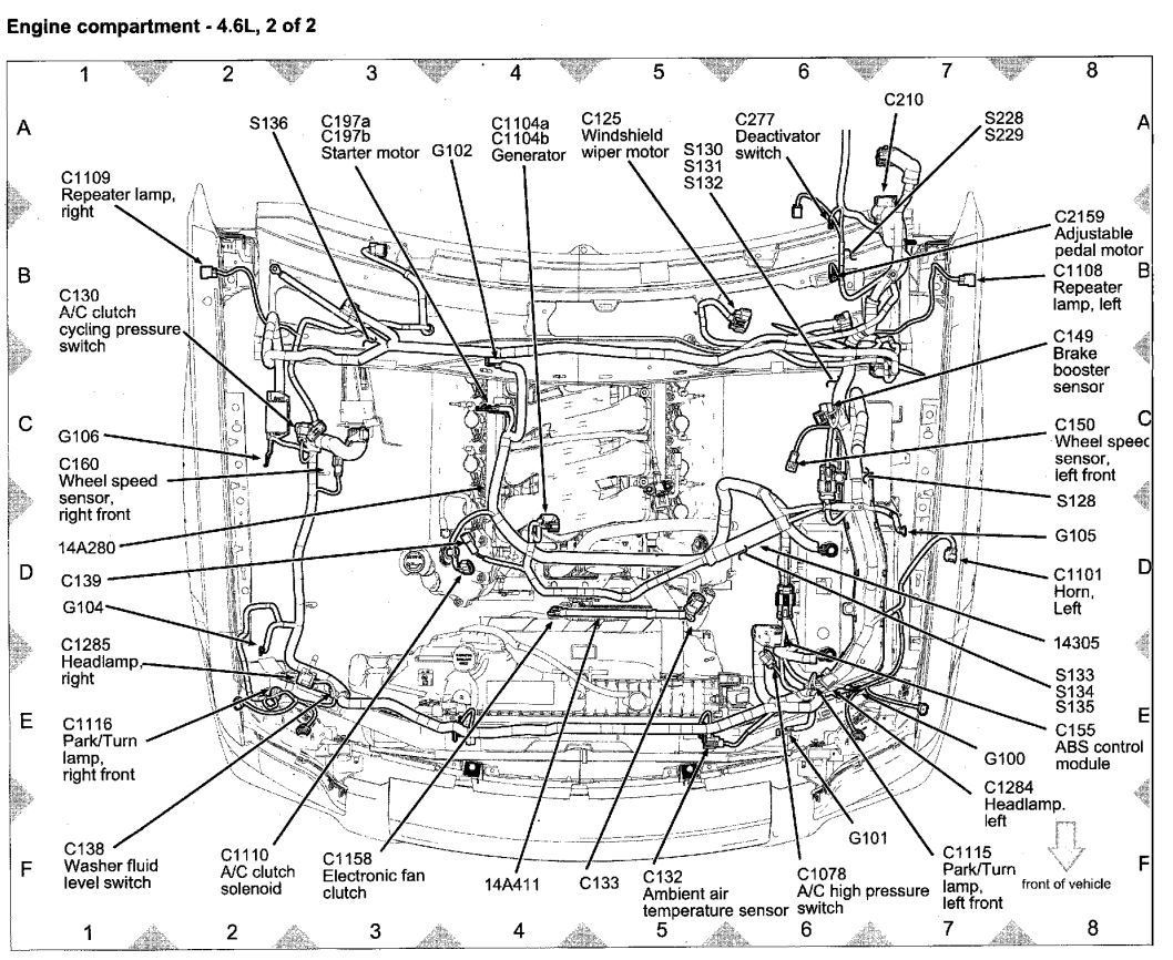

Locate C155 in diagram below:
If you look at C5 you can tell you might not even need to replace the ABS control module.

You should first try the test from C3 to C5, then clear the DTC and see. You might not even need to run the C2 test.
If you get that foxwell you should be able to run the active test to the pump as shown on C2. If you are lucky you might not even need to replace the pump and module, just need some cleaning using electrical contact cleaner.
