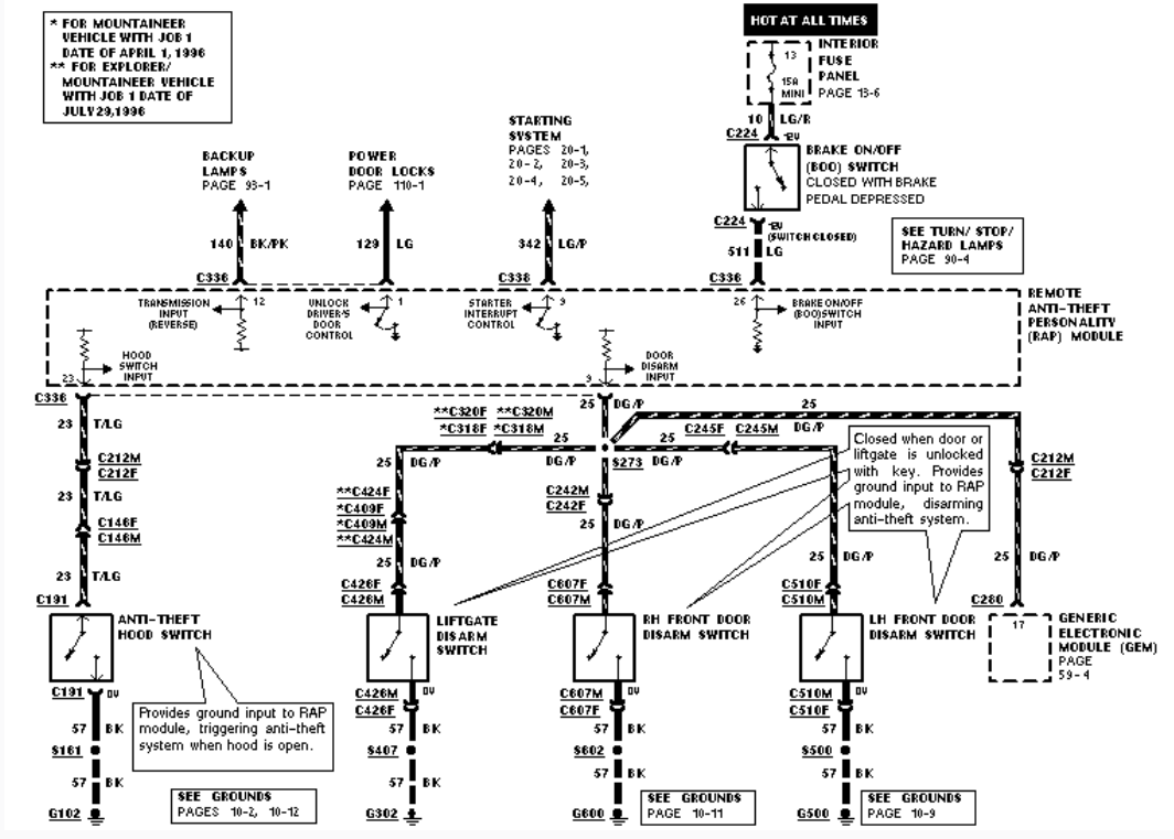

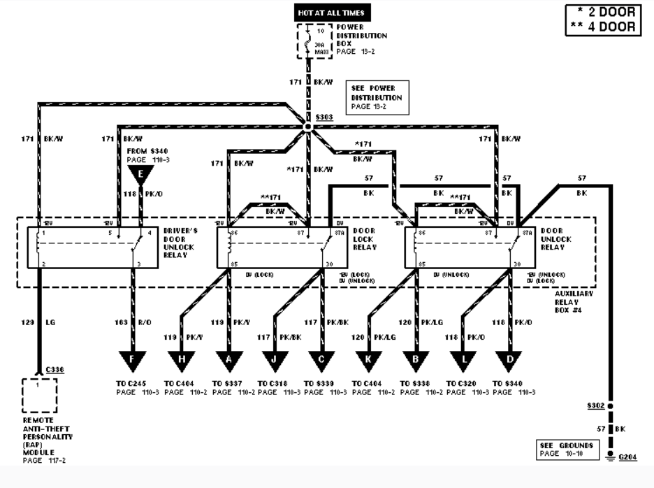

Do you have multiple keyfobs? Have you tried replacing the batteries? Are you sure all three of these worked or did you not need to notice if they were inop before the keyfobs stopped working?
These are the only two diagrams I see that are related to your complaint, I dont see any about the keypad though which is weird.
