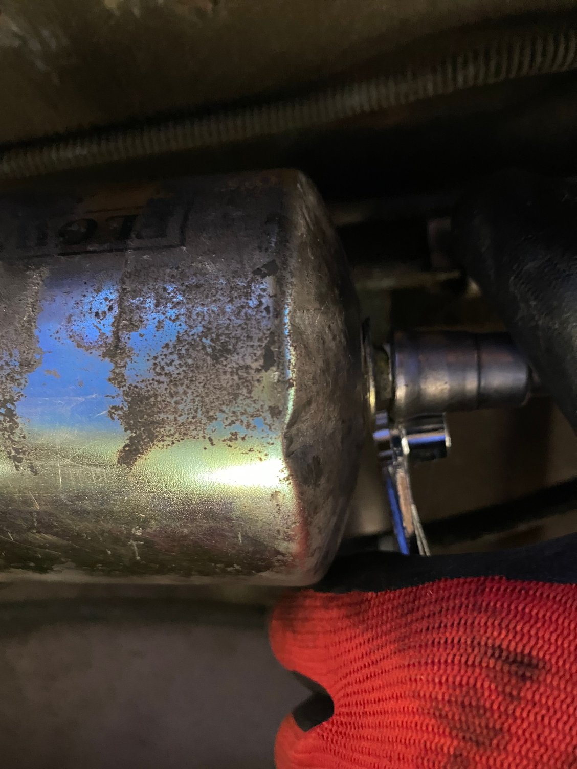

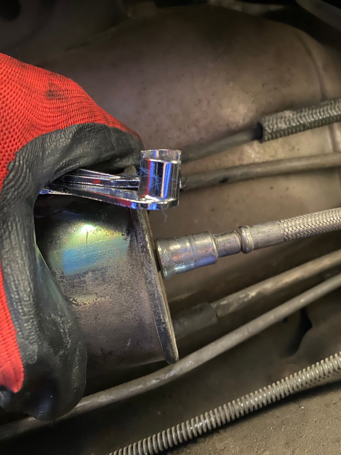

Need help removing a fuel filter from a 2005 Explorer Limited V6 4.0. See picture. I took apart everything except I could get the connector that requires a tool off. I tried for 5 hrs with the special metal 3/8 tool and even tried sharpie marker caps. Any ideas? Is there a different specific tool I should be using. Thanks everyone
I recently just replaced the suspension so I didn’t think replacing a fuel filter would be that difficult
Fuel filter 05 Explorer Limit 4.0

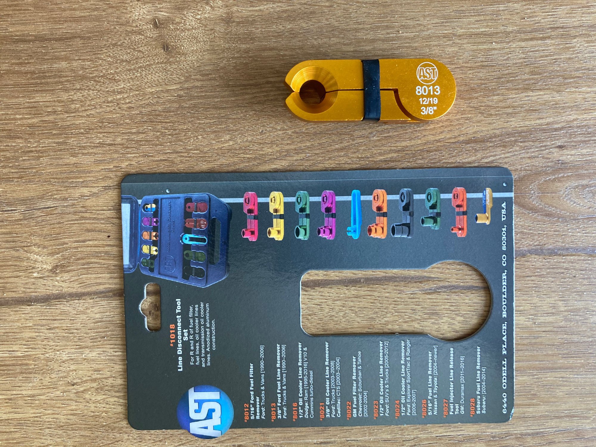

I have the AST 1018 set, the one I use most often is the AST 8013 so thats probably what you need.
You should be able to go to a auto parts store and buy them individually, heck they might be part of the tool loaner program. If you do buy it do not buy the store brand, I first bought the harbor freight ones but the metal is to thick to go into the connector, the AST ones are correctly made though.
Also you have to push the tool in harder then you think to get it to release.

Finally replaced it. AST 8013 Gold tool worked great. Came right off. Pulled the fuel pump fuse with it running to release pressure. The fuel filter was FG-1083. Sorry for the late response. Appreciate the responses. Couldn’t of replaced it otherwise. I attached some pictures.
