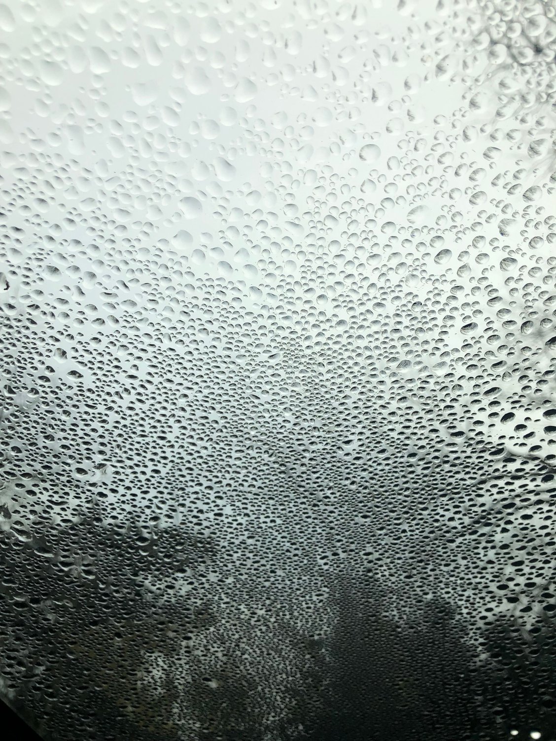

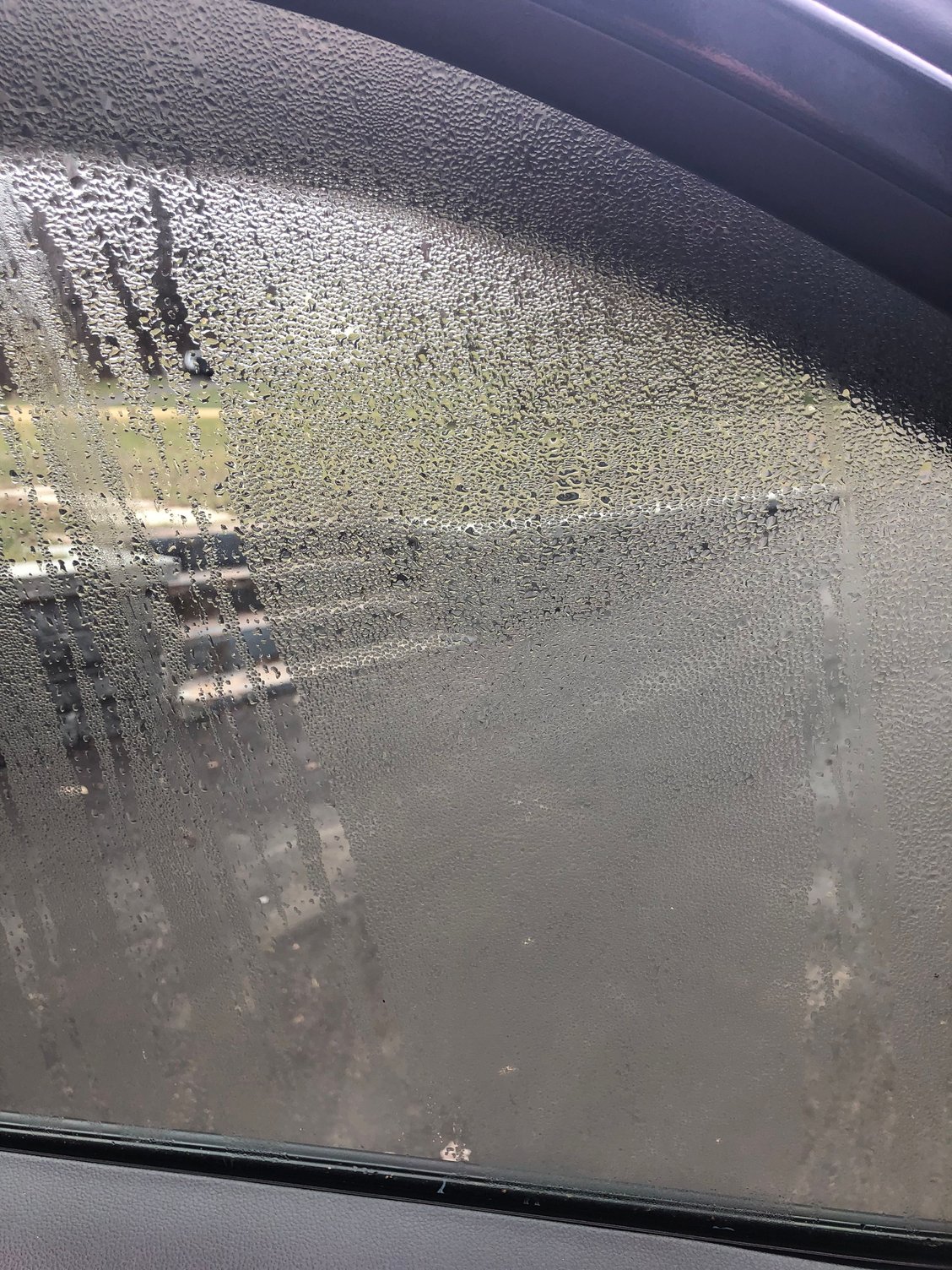

Over the past few weeks this has been happening on and off… I can’t figure out why. I first I thought maybe the wife left the windows cracked but it happened once even after I drove it. I know we’ve had some crazy temp variations lately up here in the north east but this shouldn’t be happening. I mean it’s everywhere… from windshield to back windows to front dash to headrests. Could my recirc door be stuck open? But why is only once in a while?

First ,suggest you check the coolant level in the engine compartment, if low possible heater core leak. If OK, then water has found a way into your vehicle and it just needs a way to dry out.
It would help if you wiped some of it dry,that you could get an idea of where it is coming from front or rear. If the floor mat is full of water , that will take some time to dry out.
