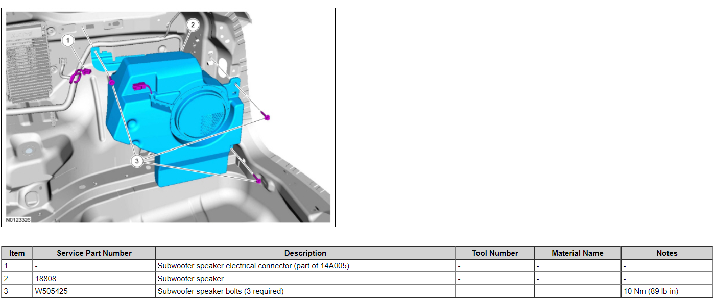

The subwoofer is behind the right rear quarter panel. Looks pretty easy to me, may take 2 hours max if you have no experience pulling trim panels.
Removal
  1. Position aside the liftgate weatherstrip.
  1. NOTICE: To avoid damage to the liftgate scuff plate trim panel, remove any retaining clips from the body and attach them to the liftgate scuff plate trim panel before installing.
    Remove the liftgate scuff plate trim panel.
    • Pull upward to release the retaining clips.
  1. NOTICE: To avoid damage to the scuff plate trim panel, remove any retaining clips from the body and attach them to the scuff plate trim panel before installing.
    Remove the rear RH door scuff plate trim panel.
    • Pull upward on the scuff plate trim panel to release the retaining clips.
  1. Remove the RH quarter trim panel retaining push pin.
  1. Position the RH second row seat in the flat position and then tilt the second row seat forward.
  1. Position the RH third row seat in the flat position.
  1. Remove the RH cargo retaining hooks.
  1. NOTICE: To avoid damage to the quarter trim panel, remove any retaining clips from the body and attach them to the quarter trim panel before installing.
    Position the RH quarter trim panel aside.
    • Pull the RH quarter trim panel toward the inside of the vehicle to release the retaining clips.
  1. Remove the 3 subwoofer speaker bolts and the subwoofer speaker.
    • Disconnect the electrical connector.
    • To install, tighten to 10 Nm (89 lb-in).
Installation
  1. To install, reverse the removal procedure.

Thanks for all the detail! So I tried, couldn't get it, then took to for dealer who told me that even though I have an xlt there are apparently different sound system levels and mine doesn't have the separate built in amp to hook the subwoofer into. Ugh.
Didn't realize that wasn't standard on an xlt. Not sure if I can buy the accompanying amp separate, or if there are other components I would need as well... might not be worth all the trouble/cost
