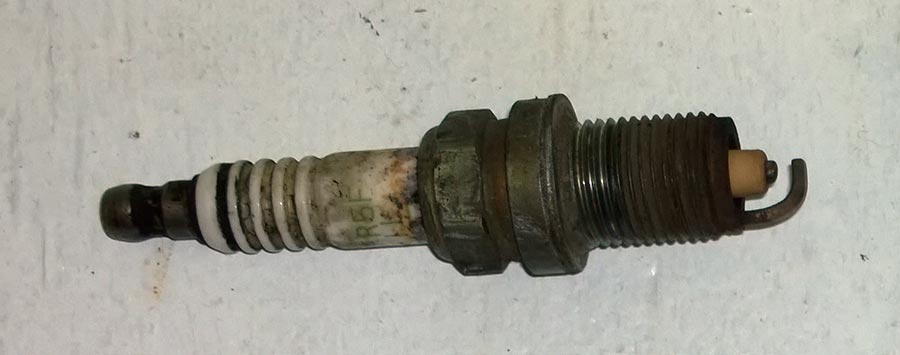

Thanks for info i forgot about ignition coil completely. I already tossed the old wires already, but my old plug from cyl. 4 looks like this.

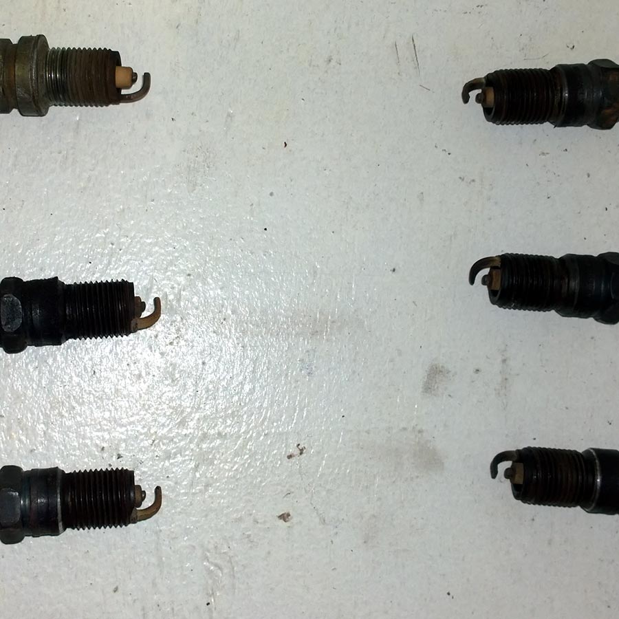

One other thing i noticed spark plugs tips on driver side of engine were somewhat dry and orange and on passenger side of engine are wet black what does it signify?

The gaps on the plugs that were replaced appear to be pretty worn.
Black color on plugs usually indicates that bank is running rich, could be sluggish oxygen sensor, weak coil spark, too much EGR getting in there preventing complete burning of the mixture, rare, but not impossible to have faulty injectors on that bank. There could be other reasons too, can't name them all.
