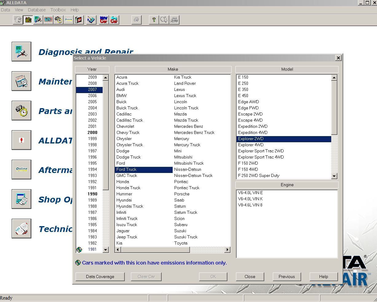

You are going to do this one way or the other.
Enter your make, model, year and engine size and request PCV valve location.

OK button is not clickable because engine size is not selected. You said 2007 explorer 4.0l but 2 possibilities still. What's the 8th character of your VIN, E or K?
