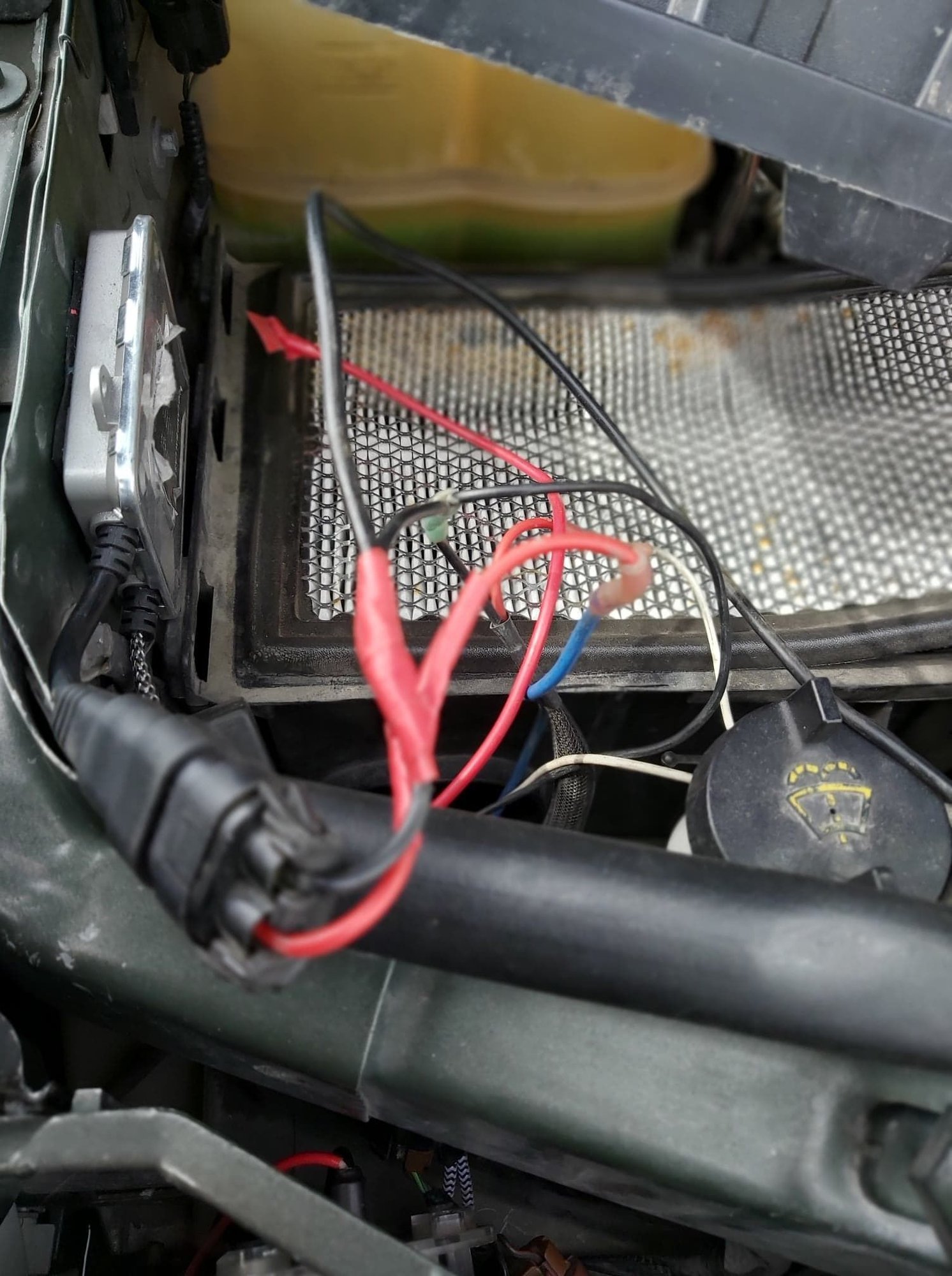

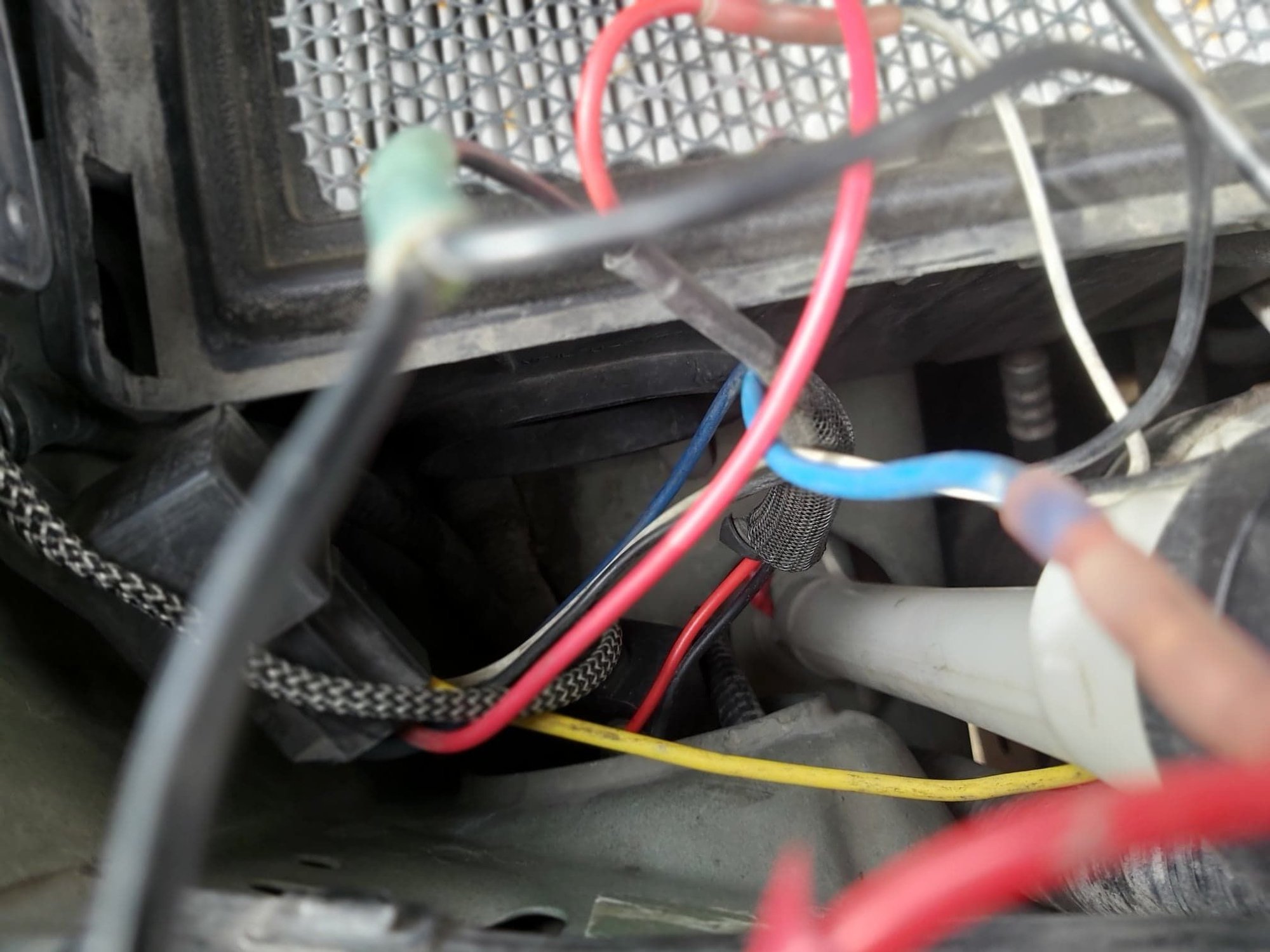

I just took pictures of the wiring on my lights if that might help .. I am sure its in the wiring.. I don't know why but I do lol
If I could just get this to be sure to stay running.. I could get myself to the city where I have more of my tools and can raise truck up if need be. I am working in my sisters yard..
I really don't want to rewire how this guy had it.... just putting this out there.

passenger side
passenger
passenger
passenger
this red wire.. every since I had bought this car there has been a loose red wire on each side of the truck. I have no cue maybe you can tell me whats up with that lol
I should really get phone to take smaller picture sizes! I will remember that next time ! srry

What you might try,
Starting at any one of the ign coils there should be a red wire that comes from fuse 38. and serves all the coils. Thanks Hayapower.
Look carefully for where "Our friend", might have tapped into that RED wire, and if you see that remove the added connection and then see if the fuse still blows
We are doing this strictly by what we think might have been done and it is difficult to see everything with only a few pix.
A challenge is always welcome, just not so many of them lol.
We should be able to help get you through this.
