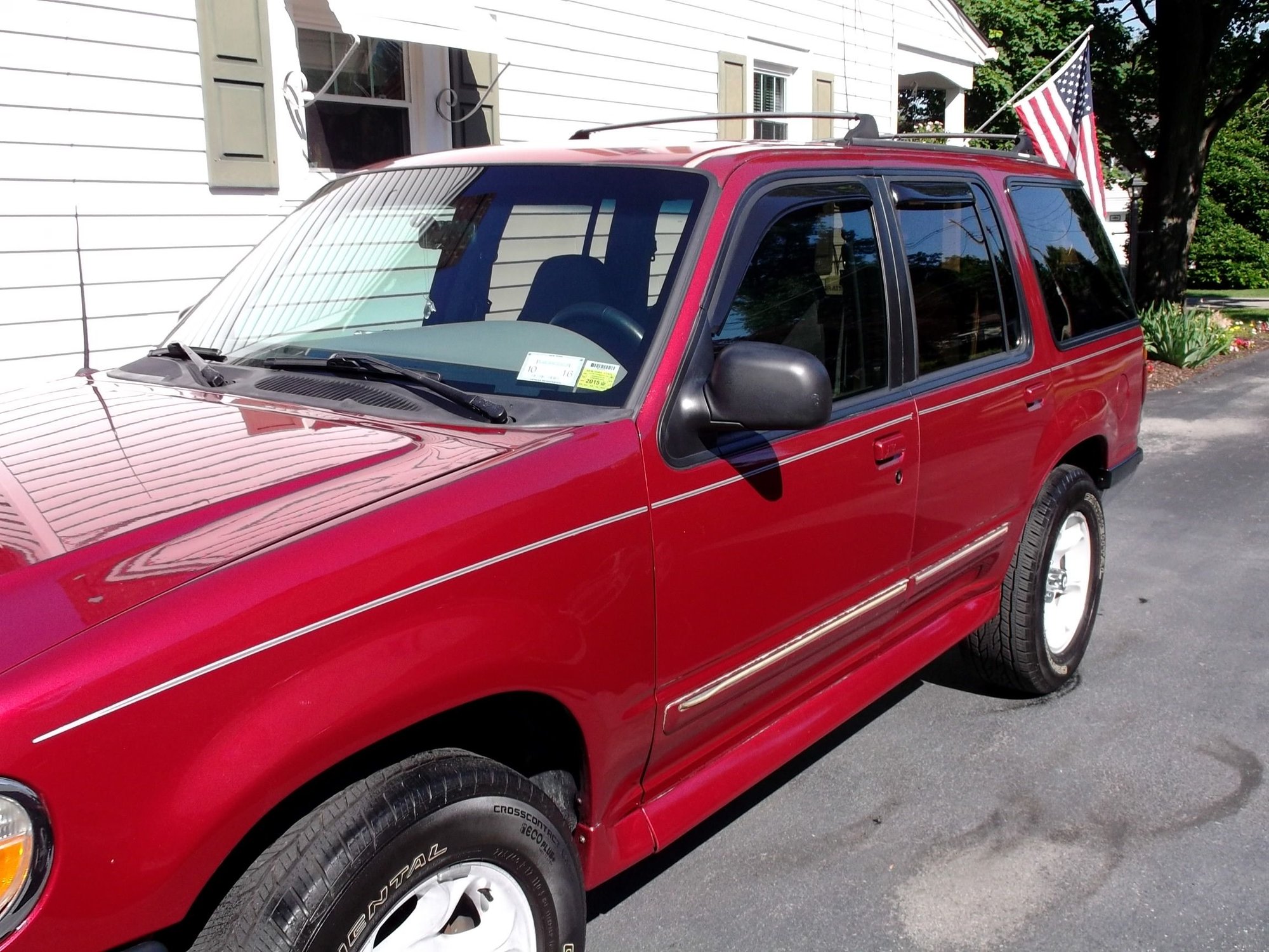

Truck has about 200K miles but is in excellent condition. I'm a fanatic

Pics attached
Old Dec 31, 2018 | 12:31 PM
Clean rig..
