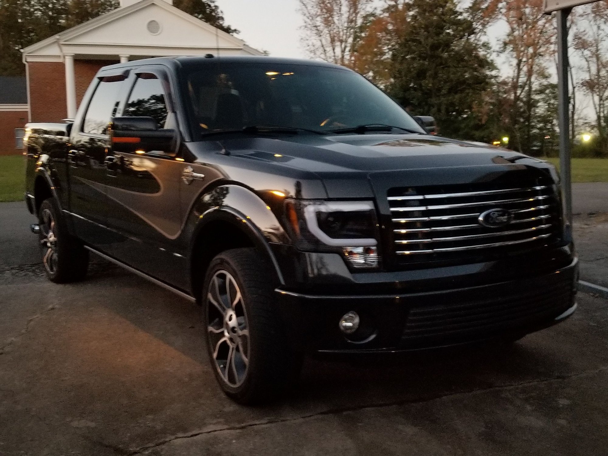

I have coolest looking truck om the planet. 2012 Harley davidson f150 with 6.2 engine, 411 hp. Got it used, has 97,000 miles on it, transmission fluid has never been changed. I have read every post here and i am conflicted. I talked to Ford about fluid says it should have been changed at 60,000 miles. They flush the transmission but don't put in a new filter. The truck has no issues, it runs so smoothly, you never even feel it shift. The fluid is not burnt it feels like new to the touch. It is still at full line, the seal hadn't even been broken till we checked the fluid. What should I do?
