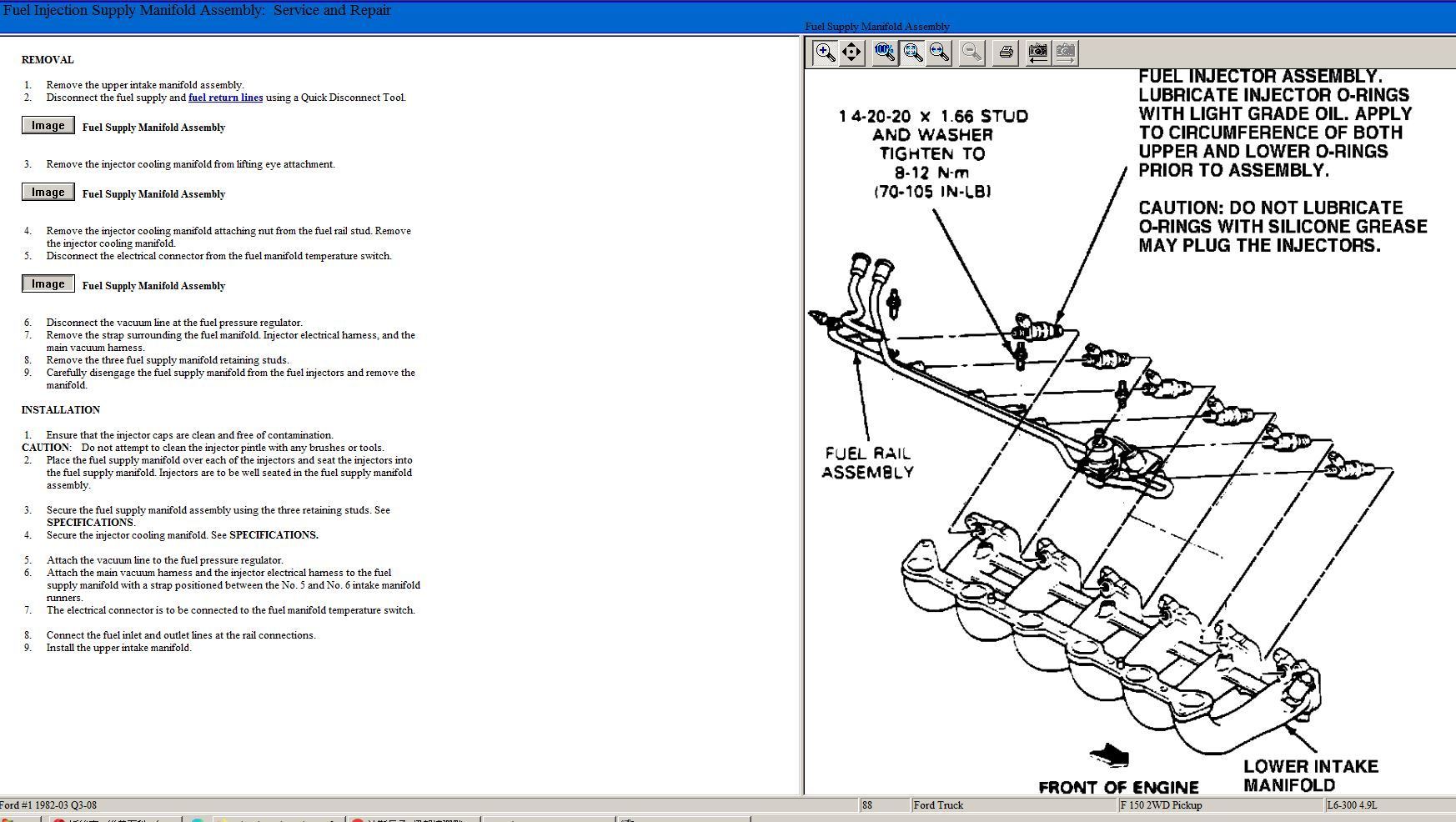

Look below "installation" step 8, the fuel inlet at the rail connection, that should be where you need to add the inline adapter like this in order to attach a gauge. Look at the two pdf below for correct size.

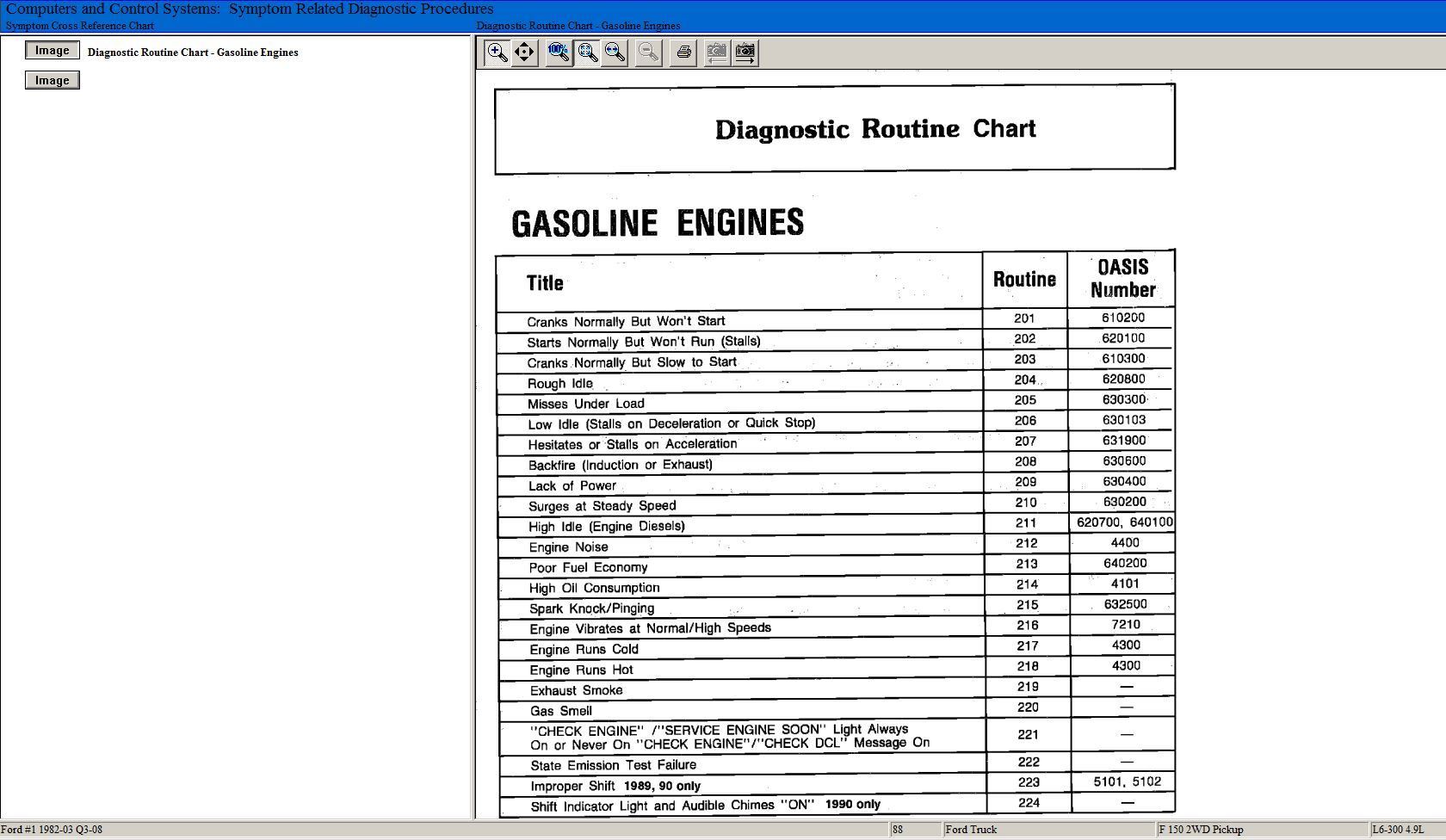

Here is a list of diagnostic routines if you need to look at any in particular let me know the routine number it's from my Alldata software.

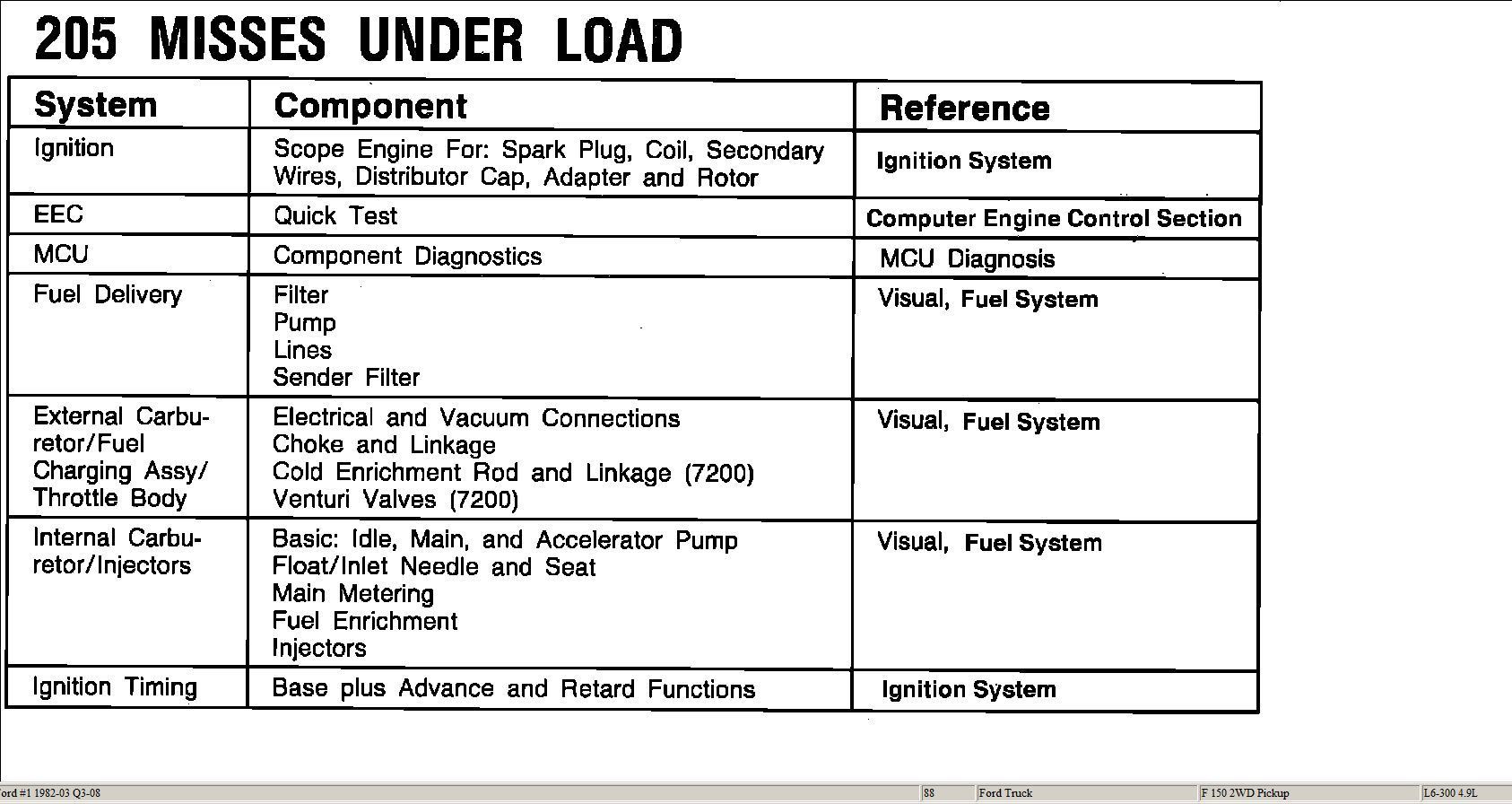

It'd be routine 205 or 207 I'd guess. Ive had plenty of cars run and drive with tps issues., Mal adjusted, broken, etc. I dont think thats it. I also don't see how the iac or blade adjustment would make the truck do what it's doing. Even if the iac is open when its not supposed to be, I'm opening the tb anyway letting in metered air via the gas pedal. Same with blade adjustment. It would be different if it stalls trying to idle or on decel but this is a cut out on acceleration and if you let off fast enough it will catch itself and idle again. It also only does it when warm so closed loop mode.
