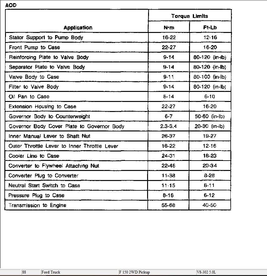

6-10 FT-LB shown above, so do exact 10 FT-LB.
