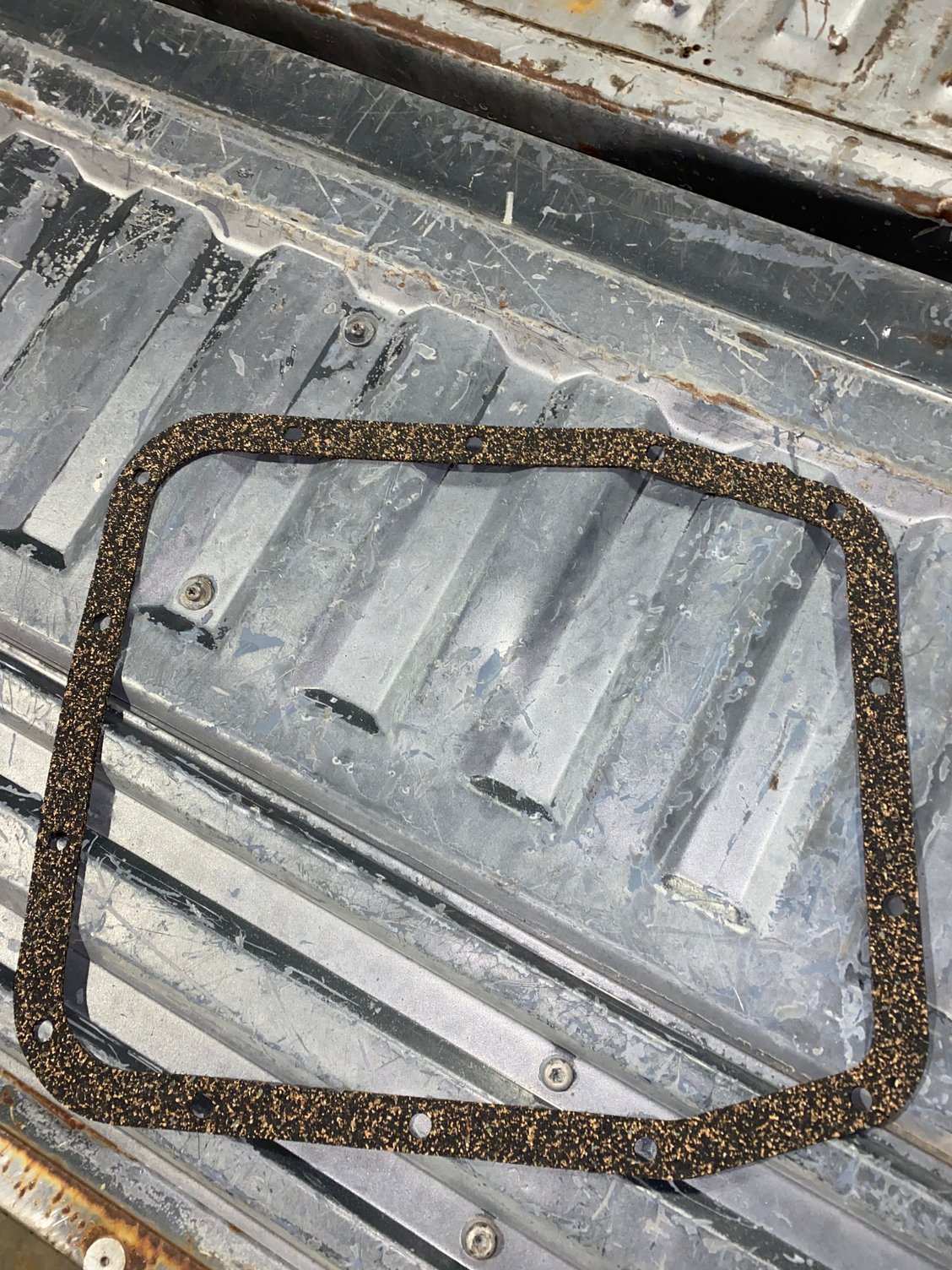

Yes it’s a 5.0 sorry about that. And I will check it out before I change them, and would cork be the best bet? Since rubber might not possibly seal right it it isn’t clean clean?

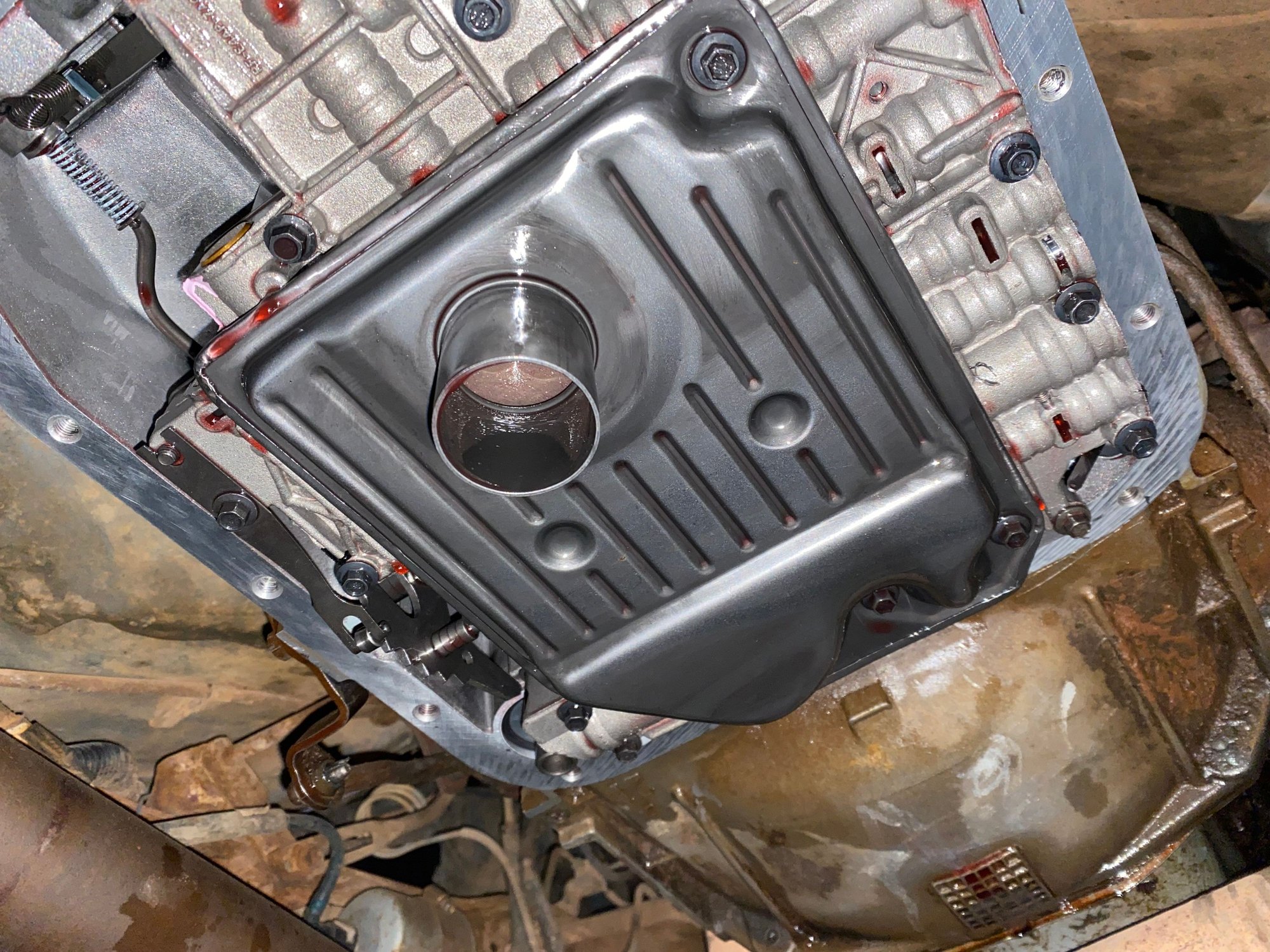

Got to work on it now. She’s all clean and ready to be put in I believe
I’m going to keep a close eye on it for a few days and see if it drips or not

Check the pan for pin holes (rust).

I have, no rust it’s pretty clean. And no leaks from the pan!!
