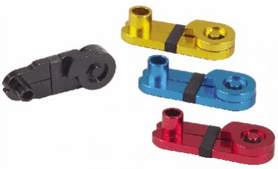

You'll need the 'quick release' tools like these.. Most aftemarket parts houses have them or something similar.. Also outfits like Harbor Freight ect will carry them..
