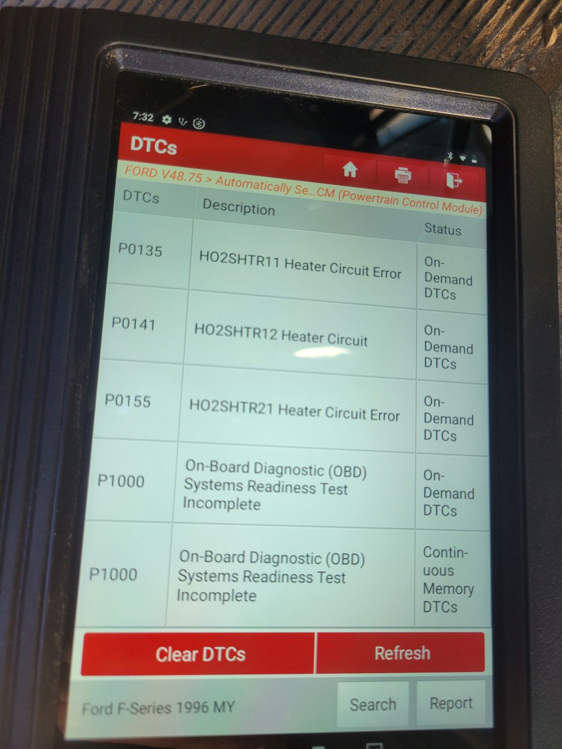

Can you tell us what codes you need to clear? Need the numbers, thanks.

Default Codes
I cleared the DTCs, truck started and drove it all day even started it 8 times with no problem.

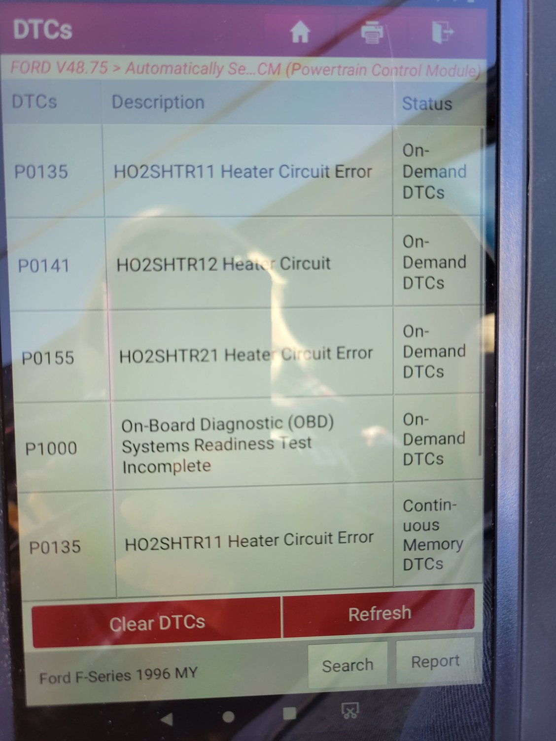

Default Codes....
