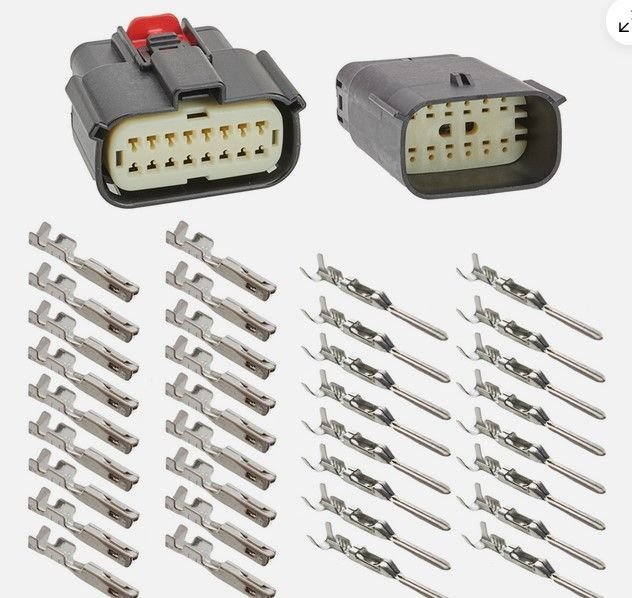

If you want to DIY and make your own plug-n-play conversion harness, first you need to identify your female connector off your headlight harness.
Let say Motorcraft WPT-1731 is the repair harness like this, is that what you have?
Without cutting your factory headlight female connector you will need to look for the male connector to plug into it.
And this seller sells the male + female combo at: https://www.ebay.com/itm/265880804079
Like this below:
You just need to use male connector, of course qty 2 for a pair. So you might want to ask the seller if he sells just the male, and you need qty 2. You also need some 16 to 20 AWG wires. Once all wires are crimped, you have just a so-called pigtail, so no cutting to your factory wires and lower your truck's resale value that's most important. This DIY project is definitely doable without paying $300. I don't know what new headlights you have and how the connector looks like, so you will need to locate a female connector that can plug into your headlight, to turn the pigtail into a harness.
