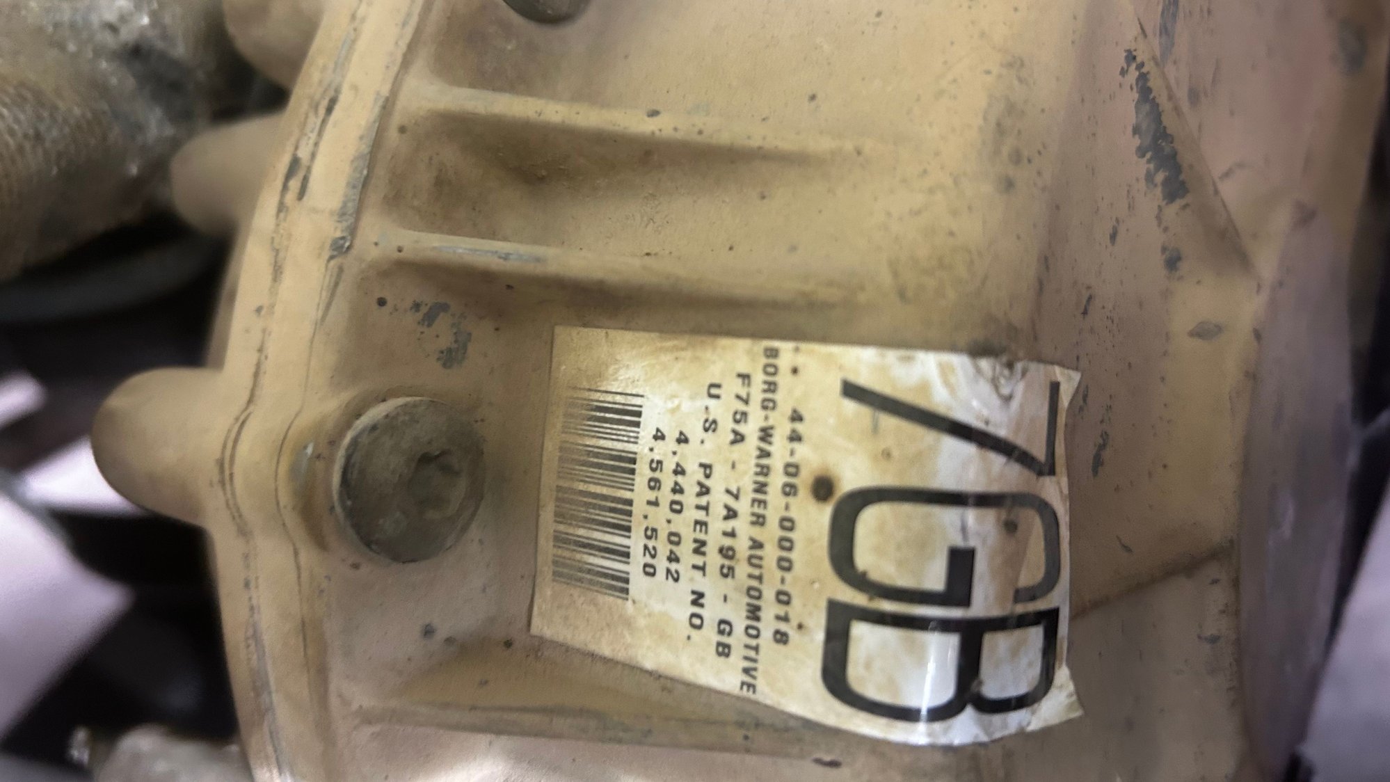

well the front seal was letting tranny fluid in, and I’ve had a grinding noise come from the output side of the tc. Upon inspection I discovered I have an electric coil on a manual shift Thor is it a torque on the fly? I guess they started using these tc’s in 96. So I’m just trying to get my head around what I have and what I need.

the eighth digit is “W” I am looking for parts diagram. I have a gear that the coil sits inside of that has metal chunks in it. And there are scrape marks behind it from gear teeth getting pushed past where they should be. It sat below the first fork(nylon)

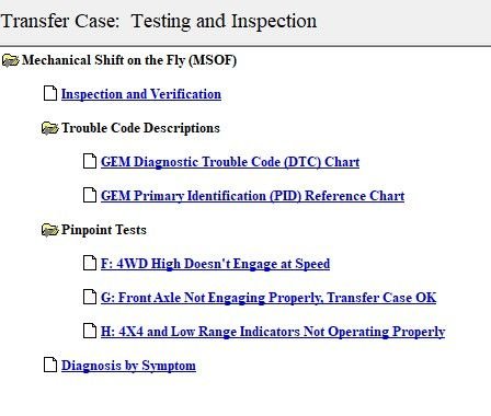

MSOF-Testing_Inspection index page shown above.
