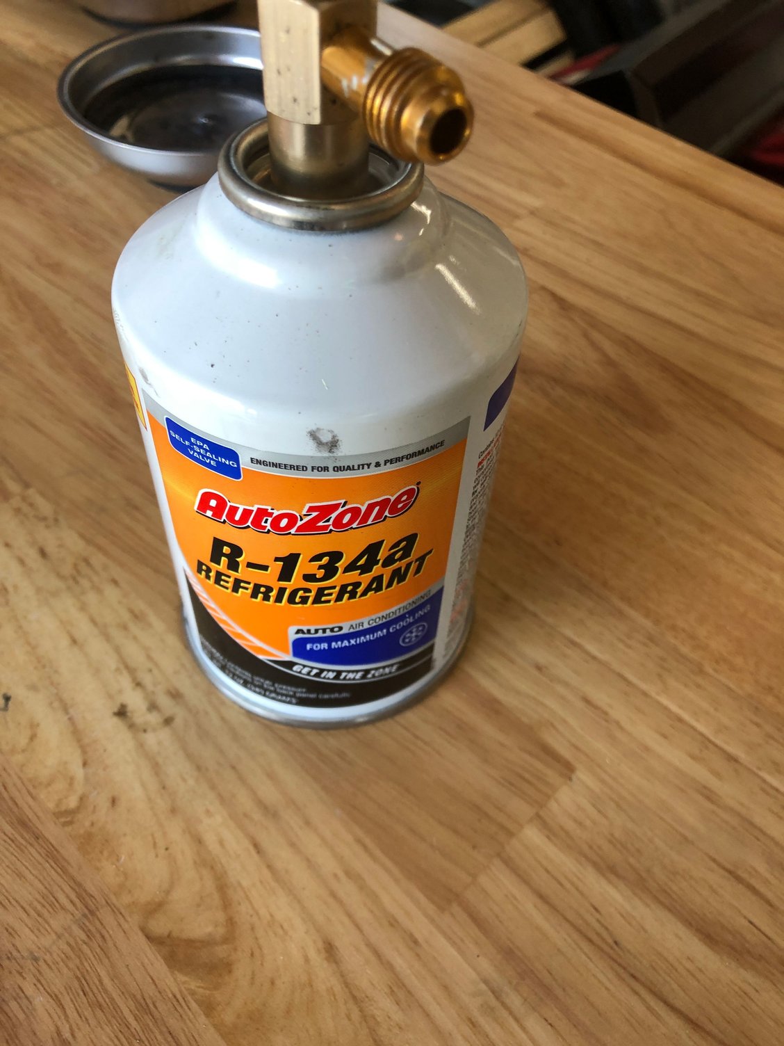

This is an ongoing issue I've been having for a while. Looked at the other forums and couldn't find the answer I have been looking for. Situation is I start my truck and let it idle with the A/C on and within a few seconds running at idle boom, all my refrigerant starts spewing out. This isn't a leak either, when I have it at full blast driving I never have this issue, just at idle speed. The first time this issue happened I replaced the condenser, thinking it was clogged. Soon after, same thing happens again. Then, replace the hoses the next time, making sure to vacuum out and properly fill the system each time. New hoses, same issue. Finally just got to the point where I am now with a complete new compressor and accumulator. The other parts aren't even a year old yet. No matter how little refrigerant is in the system the same thing is happening so there's no way it can be over charged. Using auto zones R-134a as well, the one without the stop leak in it. Any suggestions on to where to look to start diagnosing this problem?

The other thing I wanted to verify was , when charging the system after you are done evacuating it, you add the refrigerant to the low side with the container UPRIGHT , so only gas goes into the low side.never allowing liquid refrigerant to get into the low side. Doing that can wreck the compressor since it can only compress gas and not liquid. Could that be what happened?

Looking at it now that could be what happened. Maybe shaking it up let some liquid refrigerant get in. I think I’m going to try a different brand of refrigerant and do this all over again carefully and let you know what happens when I recharge it this time.
