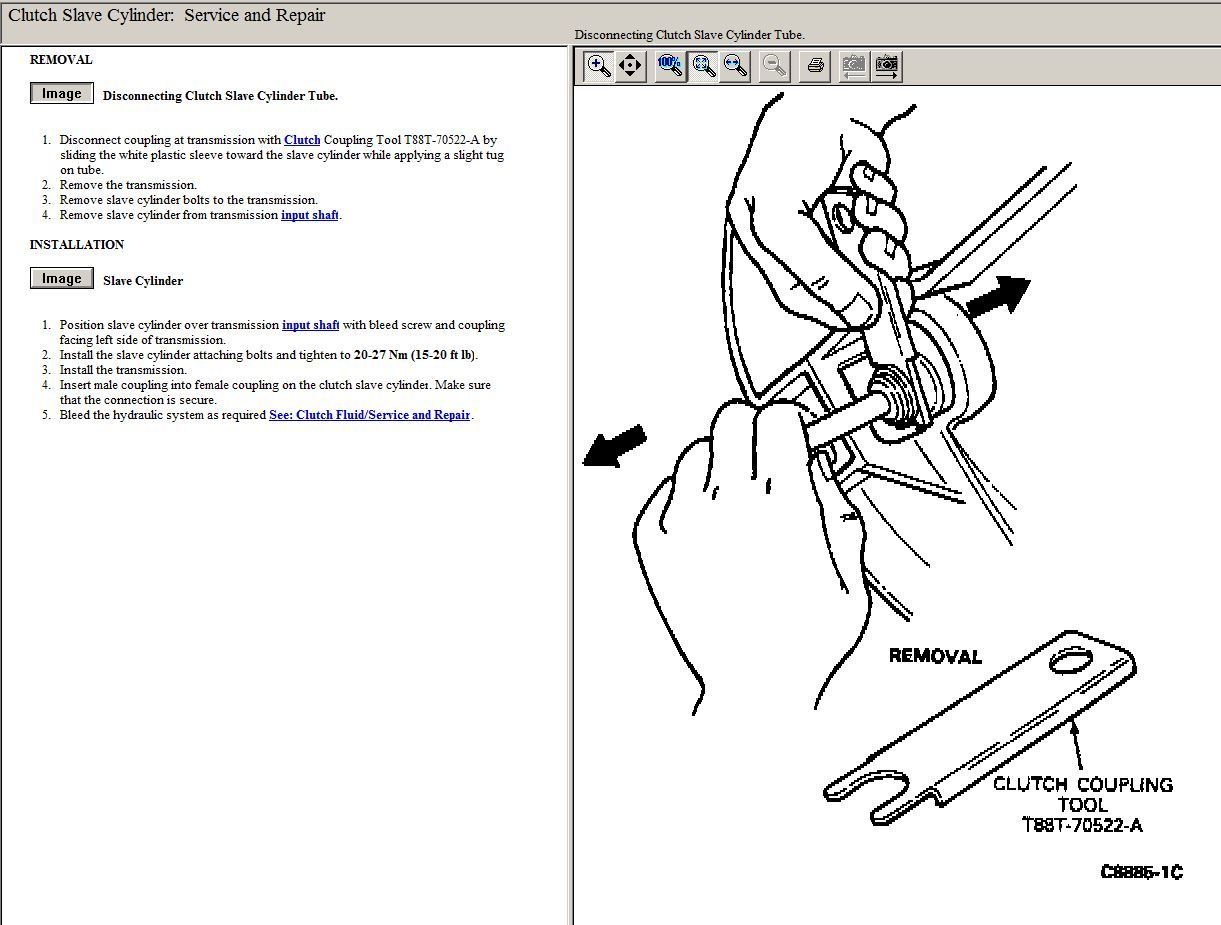

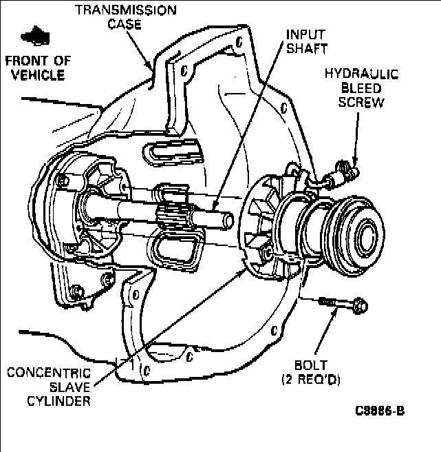

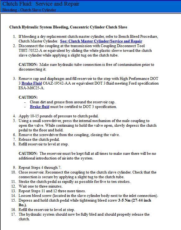

Before you bleed check for leaks and cracks, and get all the parts ready.
Don't forget to download the PDFs below, too many pages to attach as jpg individually.

Either crack open the bleed fitting on the release bearing OR crack open the line from the clutch master cyl and see if it will engage now..
If it will still not engage, there is a good possibility the clutch disc is completely worn and may require replacement.
