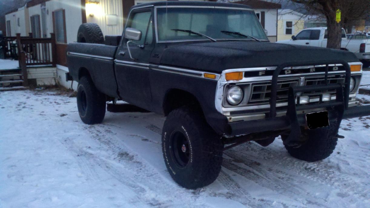

Got my truck back a week ago. Truck drives a lot better now!! After spending that money to get it fixed it better. Here it is all done. 4" inch lift 35 bfg km2

That is a sweetheart of a truck right there.

Thanks it has been a long time coming. A lot has been done to this truck. The before and after pics are amazing. When i first got it, it had a 351W i pulled that and put in the 400 and lots of other things. Here is a quick video of some of the progress.
