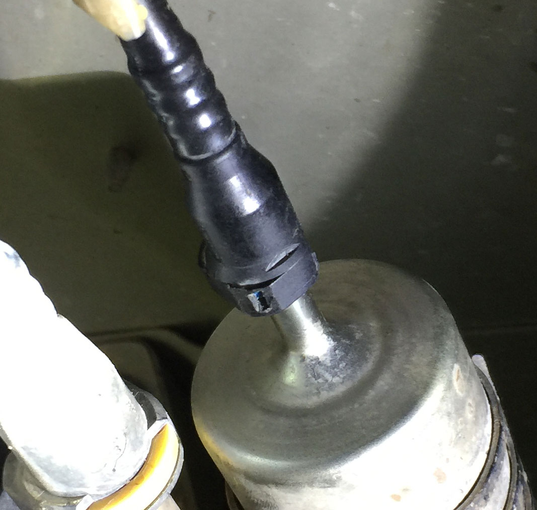

Does anyone know how to get this fuel filter clamp off?
Old Nov 3, 2016 | 05:25 PM
joshx's Avatar
Joined: Nov 2012
Default Does anyone know how to get this fuel filter clamp off?
It seems everyone else has a blue clamp one where you just pull the clip, but this one on my 2004 ford f150 is completely different
It has two holes exposing some blue inners and i tried pushing them both in but it still didnt release it.
anyone have any idea on how to get this off without using some fancy tool?
thanks
Attached Thumbnails Does anyone know how to get this fuel filter clamp off?-clamp1.jpg   Does anyone know how to get this fuel filter clamp off?-clamp2.jpg
Old Nov 4, 2016 | 05:20 AM
Posts: 16,670
You need the tool, plastic or metal, to compress the internal fingers so the line can be removed. Any other attempt will mess up the steel finger retainers and the line will come off when under pressure. The tool is usually available at any auto supply store and is not expensive.

The metal part isnt the one i was having trouble with. it was the black clip. but i found out how to get it off.
The metal part i was able to to use a pen lid to get off. Thanks for the replies.
Im just pissy that my issue wasn't because of the fuel filter
