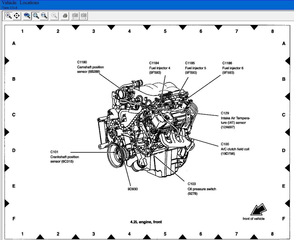

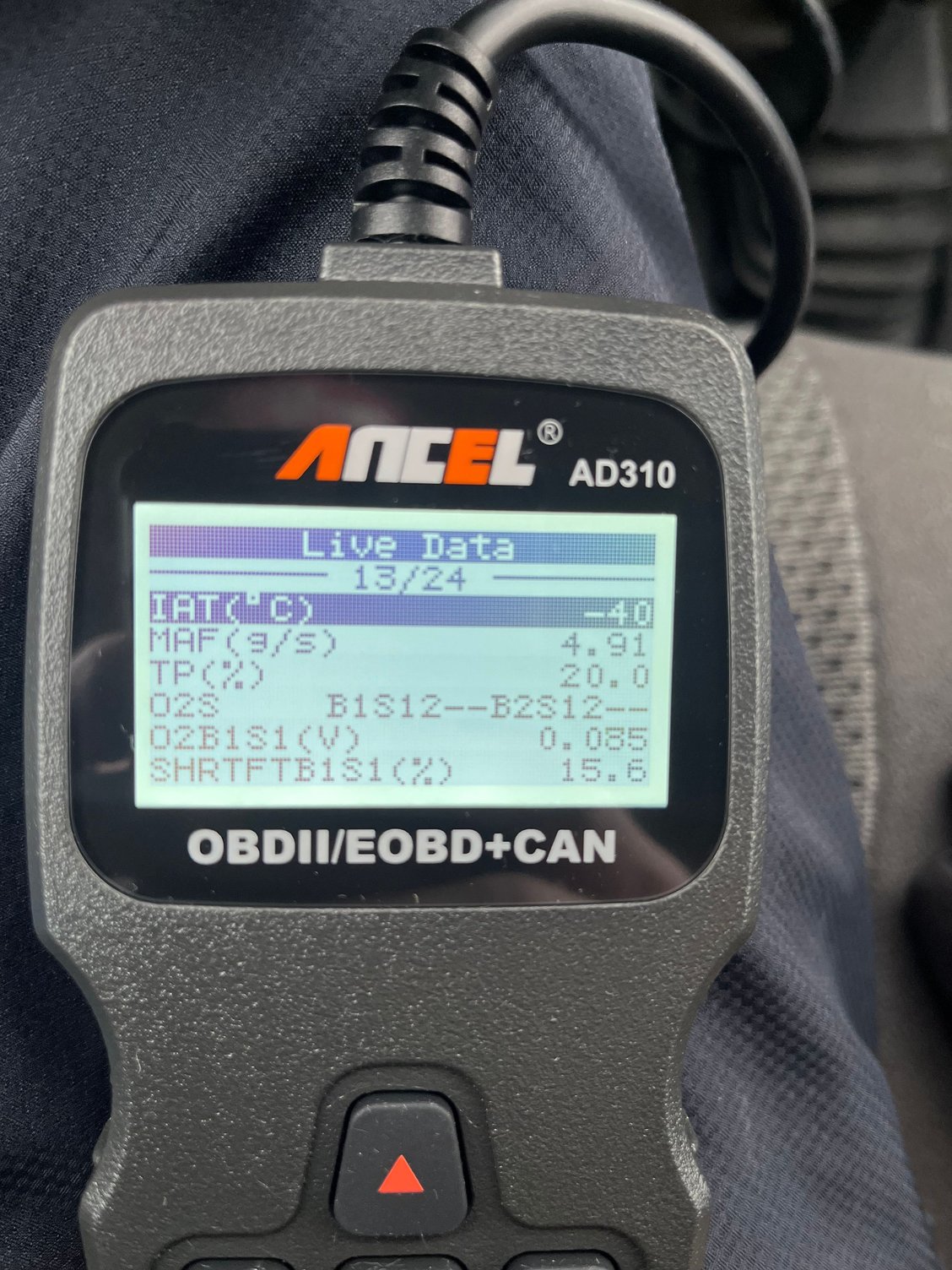

Got code p0113 on my 2003 f150 v6 4.2 xl 4x4.is the iat sensor in the maf? I replaced the maf about a month ago and now I have the p0113. Where’s the iat located?

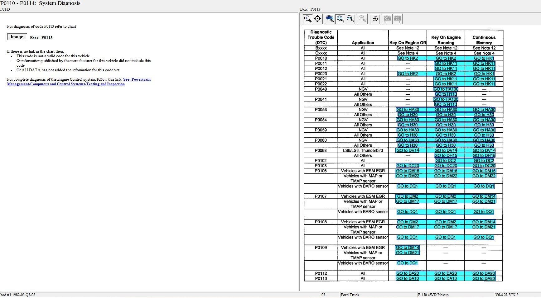

Don't just replace it, clean first using contact cleaner or 91% isopropyl alcohol on both ends of the electrical connector.
Old Dec 26, 2024 | 06:35 PM
Posts: 1,267
Find attached a huge pdf file, it covers ALL pinpoint tests, just in case you need something other than DA10 and DA90.

The IAT sensor on your 2003 F-150 is likely separate from the MAF and located in the air intake duct or air filter housing.

If the IAT and MAF are in the same component, you will have more than 3 or 4 wires in the MAF plug.
The problem wherever it (IAT) is ,the IAT is either open or not connected.. If it is separate, look for a plug with 3 wires dangling around in the engine compartment..
