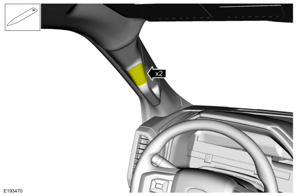

Instructions below. It only shows 1 bolt but there should be a matching cover at the bottom of the handle with another bolt behind it.

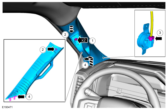

Remove both covers, both bolts, pull top of A pillar trim panel out from pillar, pull bottom of trim panel upward, disconnect speaker.Removal
NOTE: LH side shown, RH side similar.
NOTE: Removal steps in this procedure may contain installation details.
  1. Position the assist handle covers aside.
    Use the General Equipment: Interior Trim Remover
  1. Remove the A-pillar trim panel.
    1. Remove the bolts.
      Torque: 55 lb.in (6.2 Nm)
    1. Release the retainer.
    1. If equipped, disconnect the speaker electrical connector.
    1. Release the clips and remove the A-pillar trim panel.
