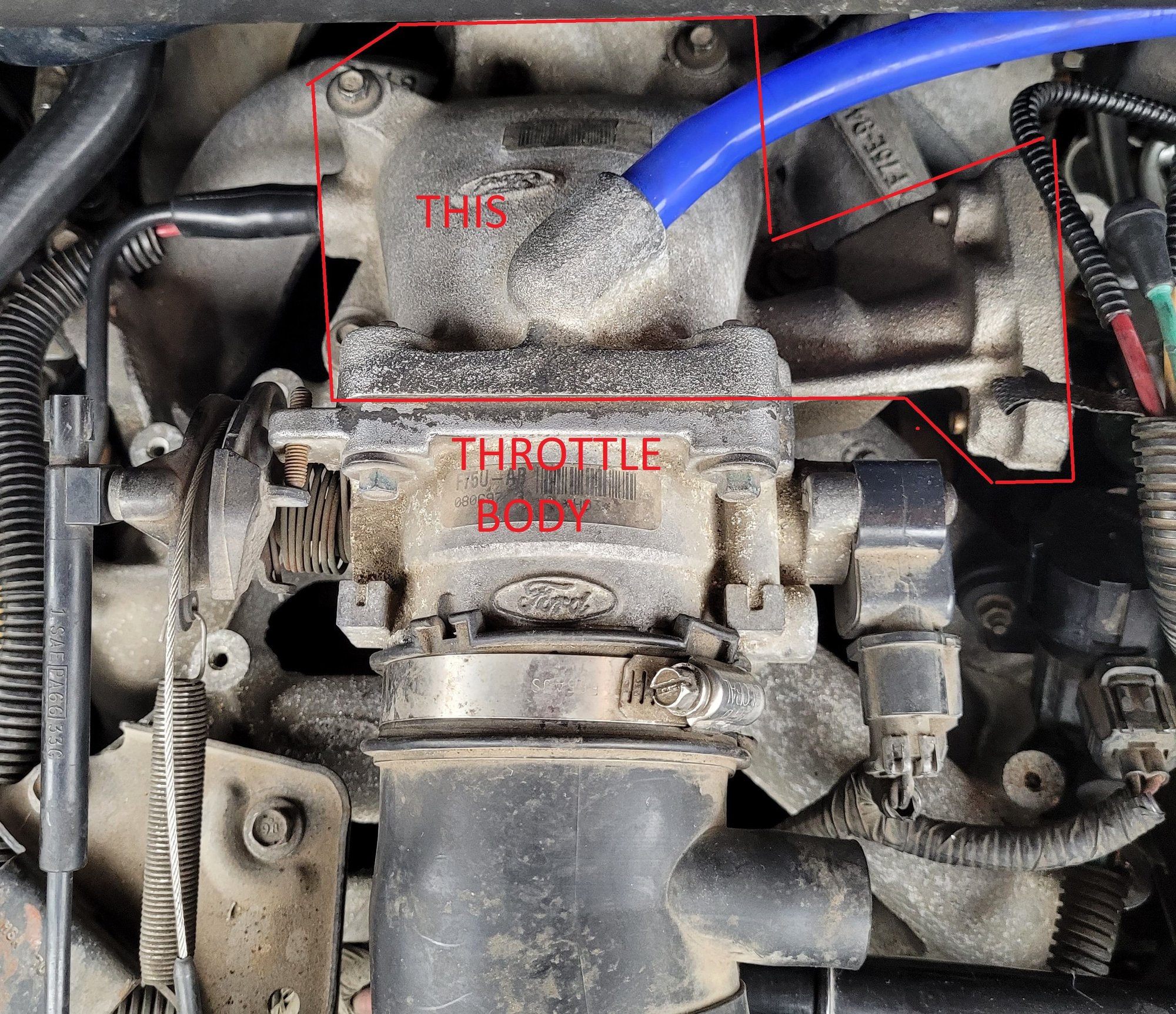

Hello All,
I busted the EGR mounting bolts and may need to replace the whole manifold (if cost effective), This is the part that interconnects the throttle body and upper intake manifold. It all has a few vacuum ports and mounting for idle control value and EGR value.
This part in not mentioned in in the huge repair manuals. (Not that I could find). All searches I made show intake manifold or throttle body. not the interconnecting manifold I need. Label says * GO3* 12117. If I had the proper name and or part number, I could do better searches.
Technically this is the light duty F250, but the engine and most other parts are the same.
I need "THIS"

It's called Spacer Throttle Body by Ford and Throttle Body Elbow by any others because Ford didn't use a meaningful name.
XL3E-9A589-AA or Motocraft CM4929 (both discontinued).
Buy used on ebay at: https://www.ebay.com/sch/i.html?_fro...=XL3E-9A589-AA
