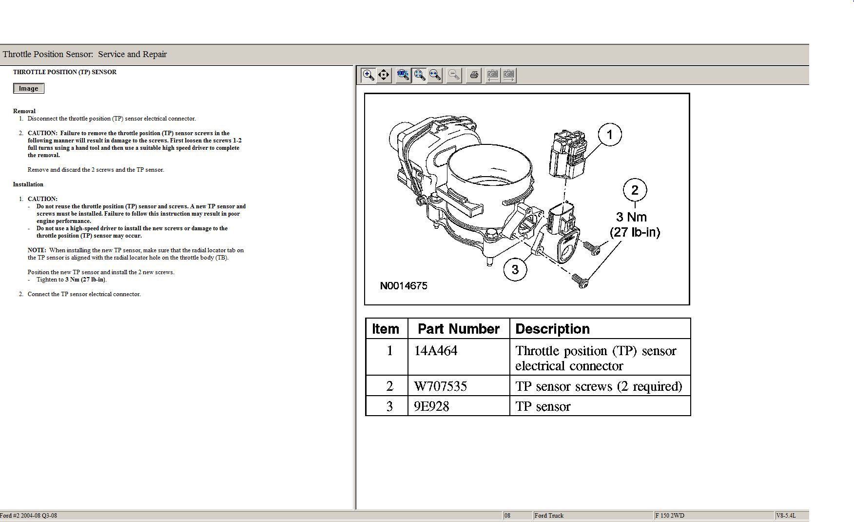

Throttle body should be cleaned routinely and it has a long lifespan and it shouldn't even need to be changed. Why you need to change it?
Below is a diagram for 08 F150 5.4L. Ford says TP sensor should not be reused. You reused it?
