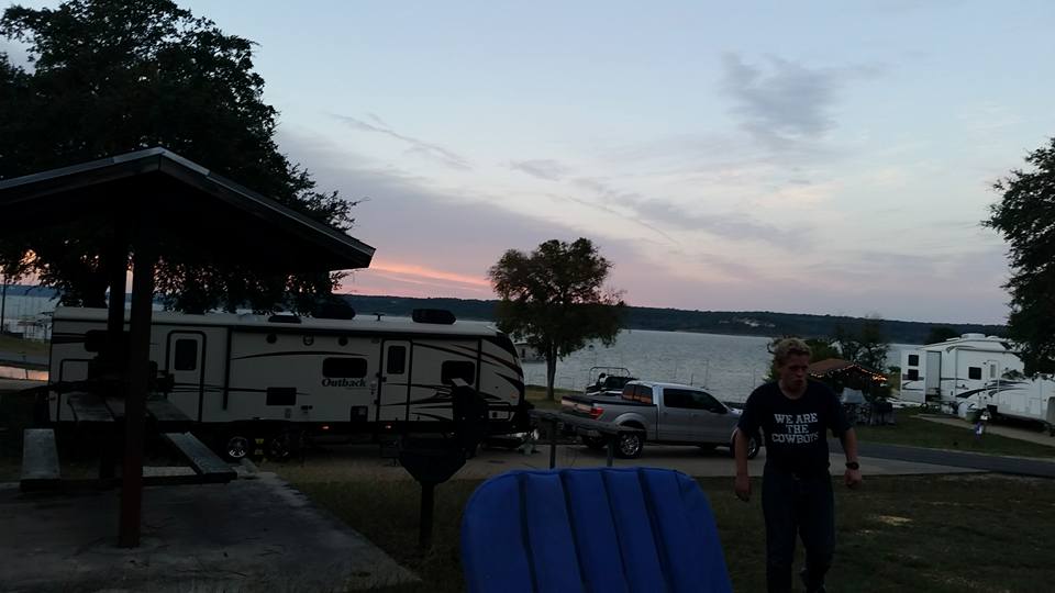

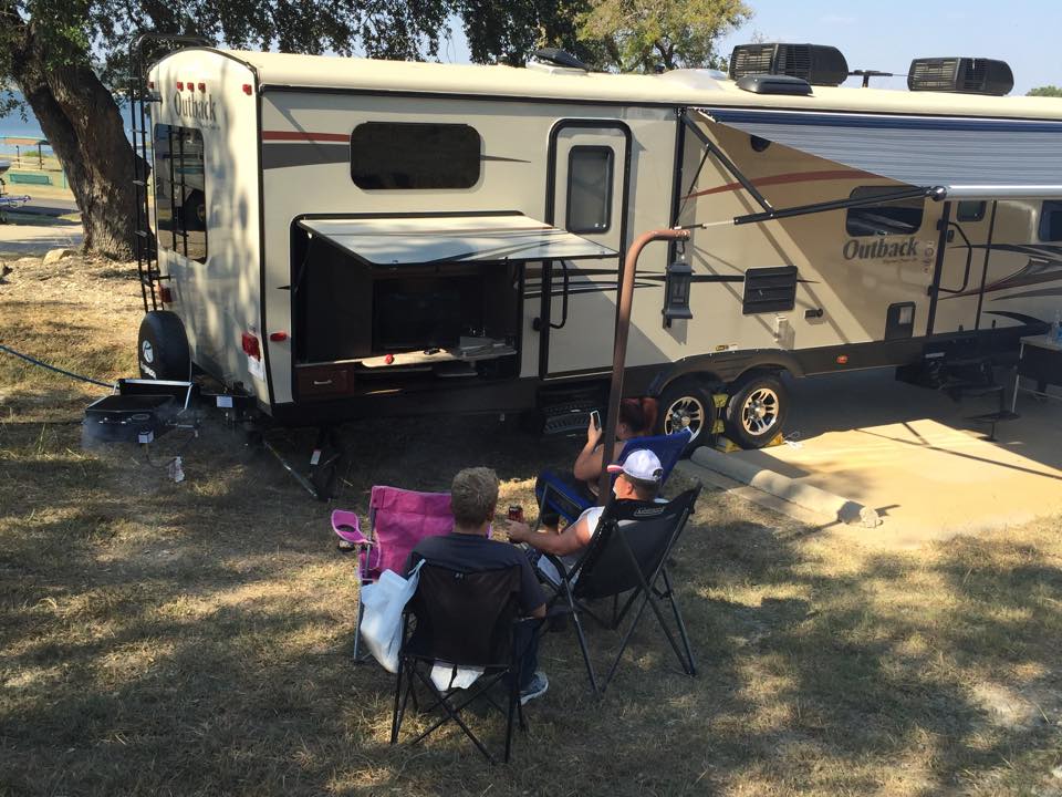

I tow a 2016 Keystone Outback 312BH the tongue wt is roughly 1000 and the trailer wt is 8010lbs. empty. I'm using a 10,000lb Pro series weight distribution hitch and I added supersprings SSA28 to the rear and the trailer pulls great. suprized how nice the springs feel when not towing also. Its very heavy but I live in Tx and have no plans on traveling over 300 miles with it and there are no mountains.
Attached Thumbnails towing question from novice-12115970_10203484076701125_5596745275471914078_n.jpg   towing question from novice-12193639_1104480472903449_4129355197908988607_n.jpg
