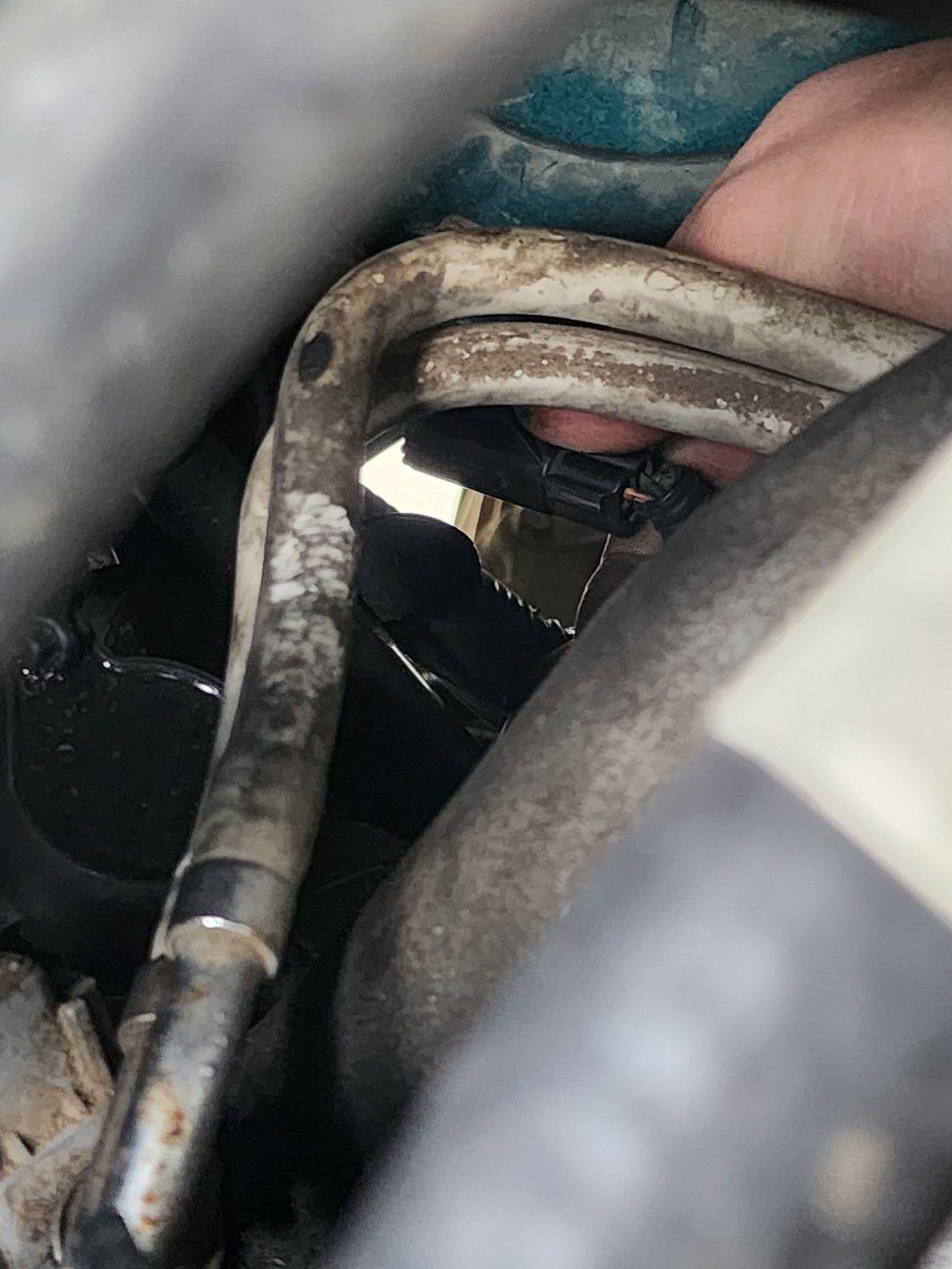

Exclamation Wire conneter need help
I had to pull my motor recently and put it back in and I have this one wire coneter left over behind the motor on the passenger side I have no clue where its goes this picture is going through the intake I can reach it but it isnt long enough to go atop the motor so it has to go behind it somewhere, thanks for your help

Where does the other end of that wire go ?
What color is it ? Does it have a terminal on the loose end and if so what kind ?
Can't tell much from the pix.
Please explain a little more what lean on the passenger side means EXACTLY..

It's coming off the main harness around the back passenger area, yeah i got a code for lean bank and it feals a little luggish

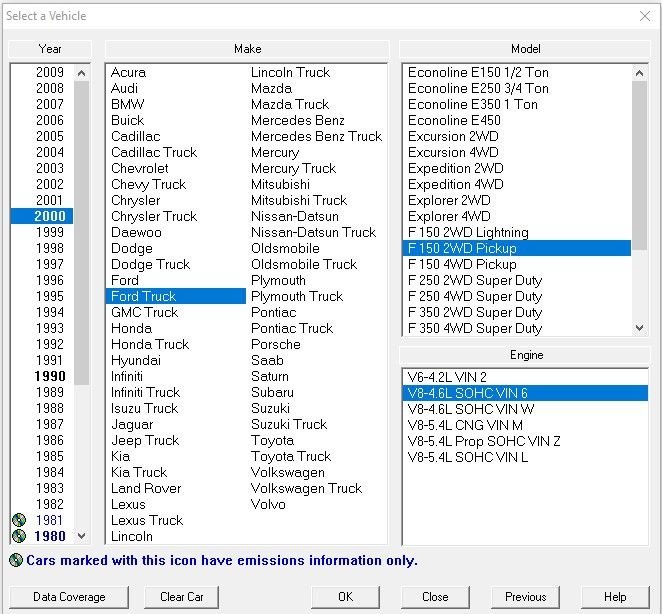

Find below with a "6" on the 8th character of your VIN. If you have VIN W let me know I will resubmit all.
If you need further diagrams or a particular connector give me the diagram or connector number.

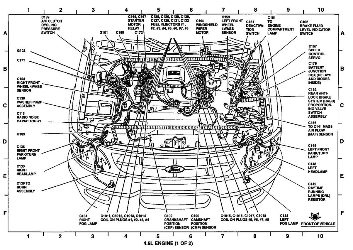

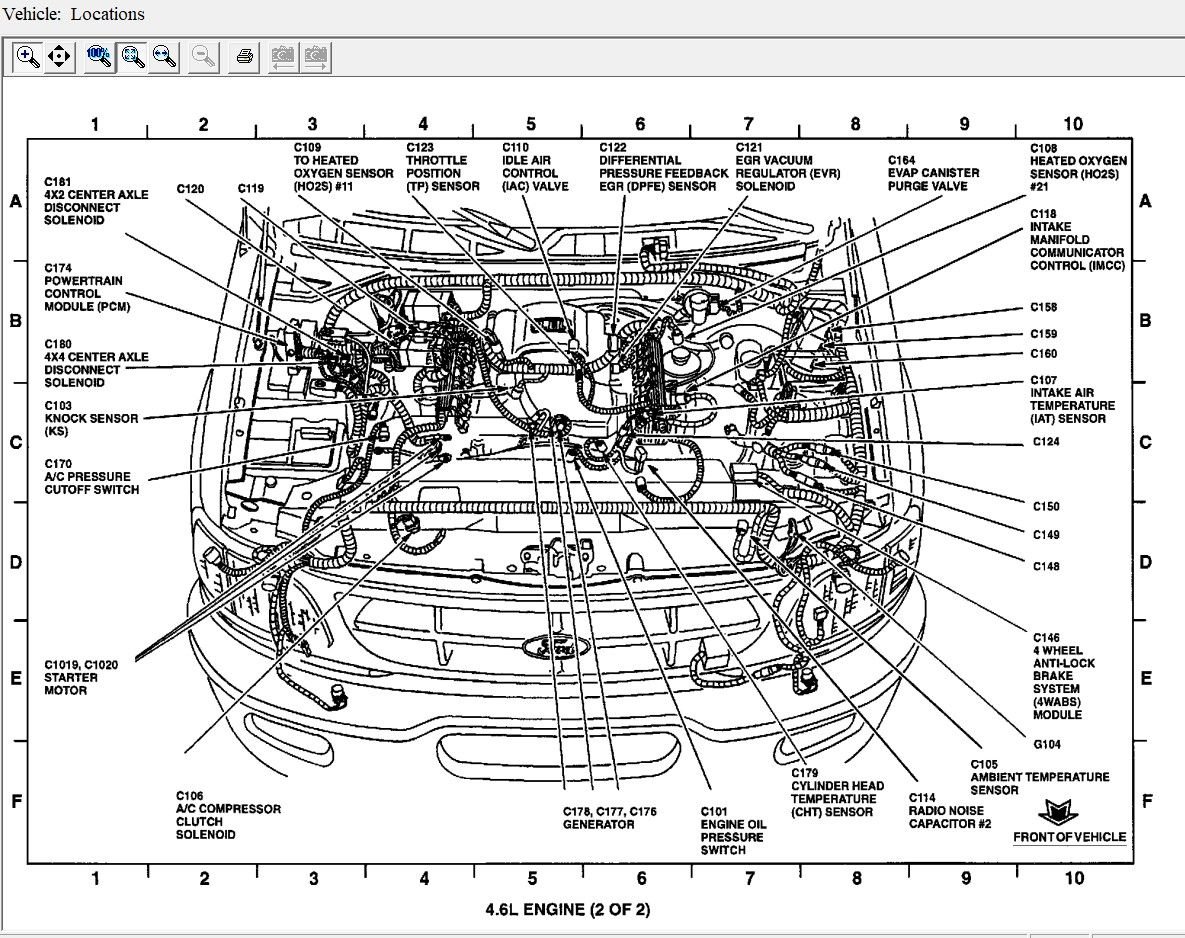

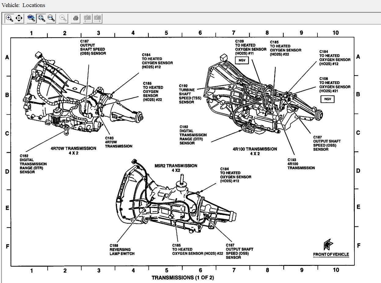

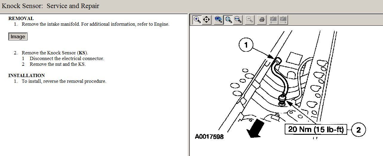

Check C103 (Knock Sensor) first, remove intake manifold to get to it so the wire to the connector shouldn't be too short. Check Intake_Manifold-Removal.pdf below if needed.
Again, everything I attached here are for VIN 6, Romeo engine.

Are you sure the oxygen sensor for that bank is connected ? Plug looks familiar !

As far as the shape of the connector and its location from the pics you provided, I can say 95% it's the knock sensor you have it unplugged.
Instructions on how to get to it and plug it back in already provided 40 days ago, I thought you already done it.
Running lean or rich is another topic, first thing you just have to plug the connector back in to your knock sensor.
