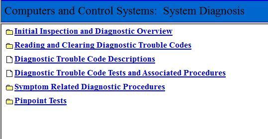

Index page of System_Diagnosis-ALL.pdf shown above.

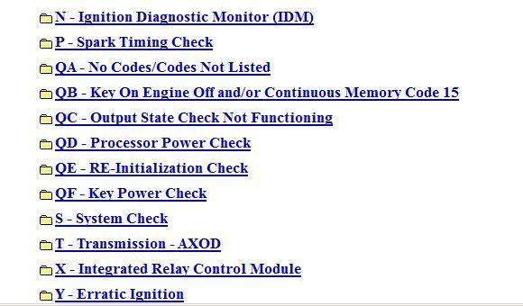

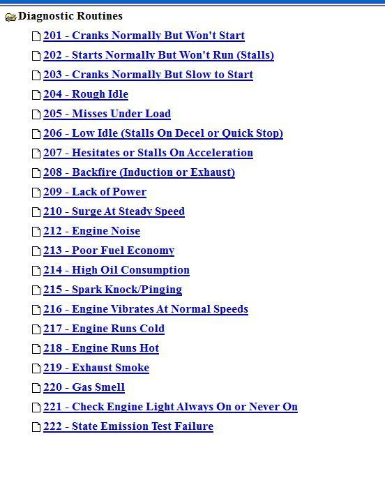

Index page of Diagnostic_Routines-ALL.pdf shown below, if you need just that.

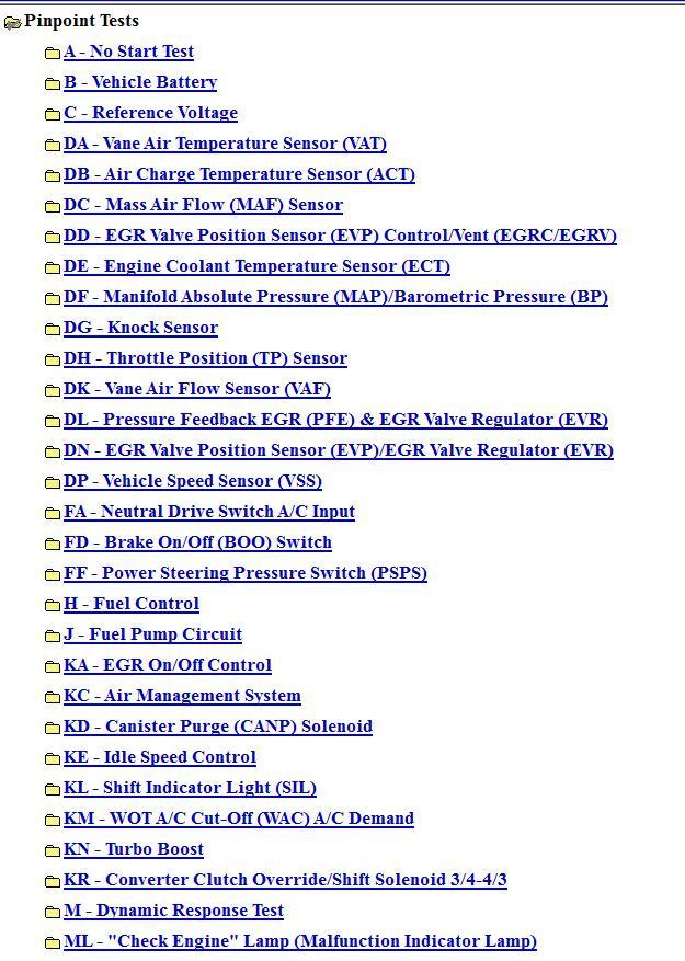

Index page of Pinpoint_Test-ALL.pdf shown below.
If you don't have a scanner like Innova 3145 you can still retrieve the trouble codes by grounding the connector and count how many flash on the CEL, check "Reading and Clearing Diagnostic Trouble Codes" section.
