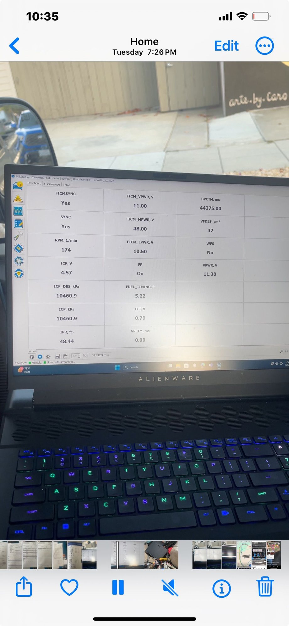

Here is a screen shot

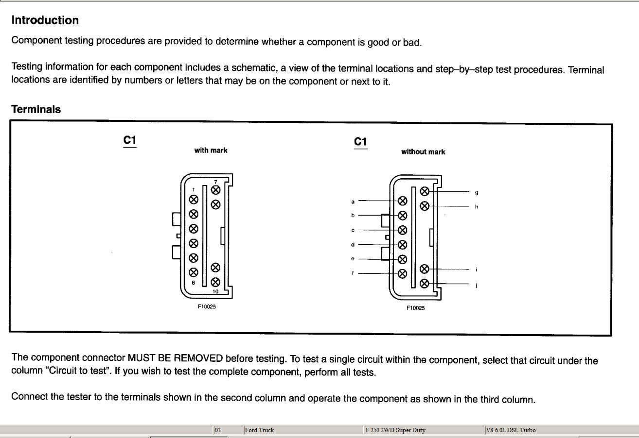

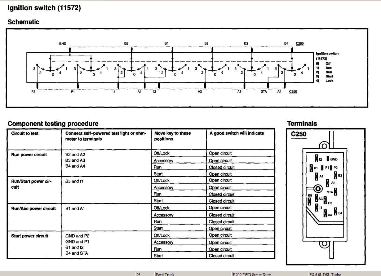

Your ICP sensor signal is likely to be shorted to the v-reference circuit. The PCM is seeing unacceptably high ICP sensor voltage and promptly ignores it - assuming an ICP value. This is shown by the fact that the ICP sensor volts are 4.57 which would equal 25500 kPa. No way to get that high of pressure when just cranking at 174 rpm.
It is probably a sensor OR a connector issue. When replacing the sensors - get ONLY guaranteed OEM parts. They are more expensive, but you will have better service from them.
Youi need to solve this issue so you know if you still have an actual issue w/ low pressure in the high pressure system (I suspect you do). I didn't see where the IPR was changed out. Please look carefully in your records to see if it was. Your issue could also be a stuck closed IPR, ie several issues could still exist. That said, the first thing needed is to get a good ICP voltage signal.

If the ICP voltage is truly low, and you believe that the sensor, connector, and wiring is good, then you should believe the voltage. The PCM will sometimes assume a pressure value to try to help a no-start situation. That assumed ICP pressure is not real and many time it masks a real issue w/ inadequate ICP pressure.
So the data you posted showed unusually high ICP voltage (4.57 when cranking at 174 rpm). Now you say it is low. Did something get changed out and cause the voltage difference?
