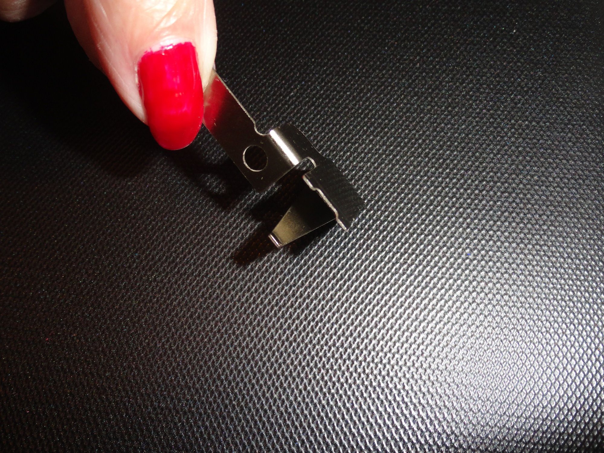

In the bag of clips that came with my pads, I had 8 clips that go on the end of each pad that spring the back away from the rotor, and also there were 2 of the clips in the attached picture. They look like wear indicators, but I have no idea where they go. All of the YouTube videos that I found show only the pad end clips. Where do these go?

I found another video that briefly showed where the mystery clips went. I installed them and everything is back together. I'm not sure what they do though. The best I can see is that the apply a little more outward pressure to the out pad. Maybe they are compensating for the sticktion in the outer pad mounting hardware and caliper, compared to the inner.
