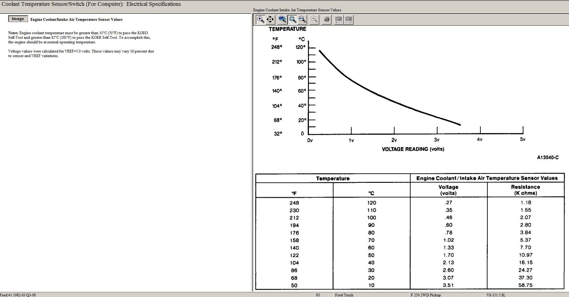

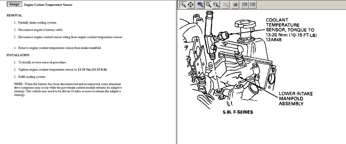

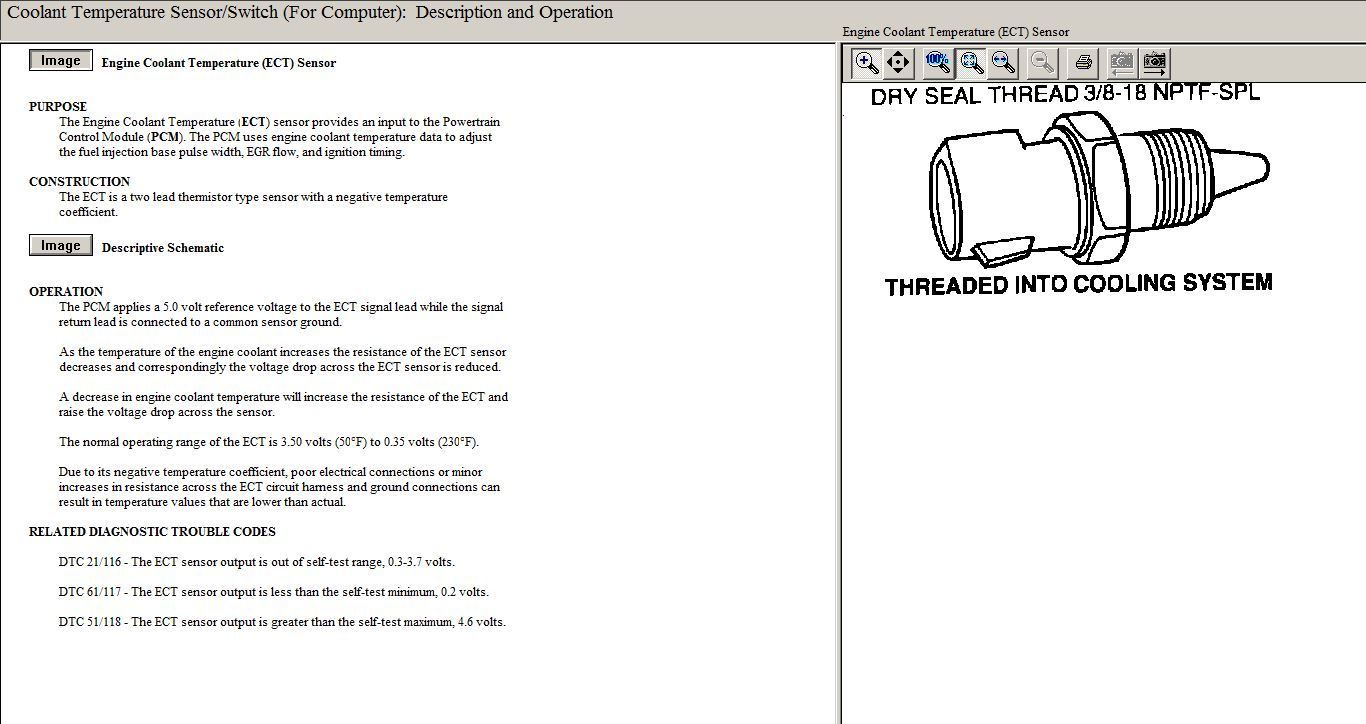

I don't see you mentioned ECT and MAF.
A bad MAF has ALL the combined symptoms you mentioned. Just disconnect battery, unplug MAF electrical connector, wait 10 minutes, reconnect your battery ground and drive for 10 minutes or so. You may experience lack of power when it's in limp mode because MAF is unplugged for diagnostic purpose, if your idle should be better and no hesitation and no sputtering, then your MAF is probably at fault. Don't be surprised your truck might have more than one issue.
For ECT follow the procedure below, don't just replace a new ECT. If the electrical connector has corrosion which can cause bad reading, clean that.
