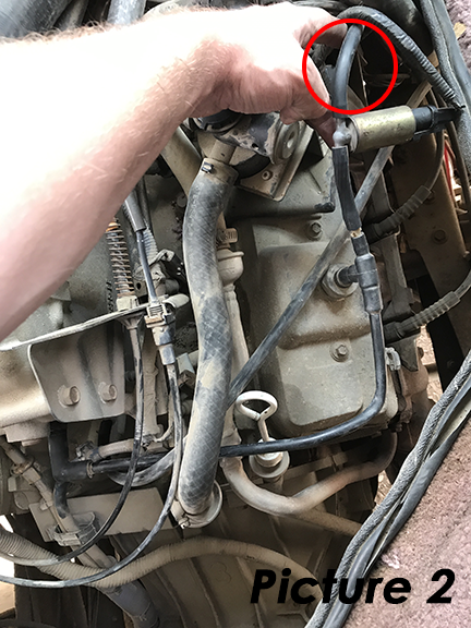

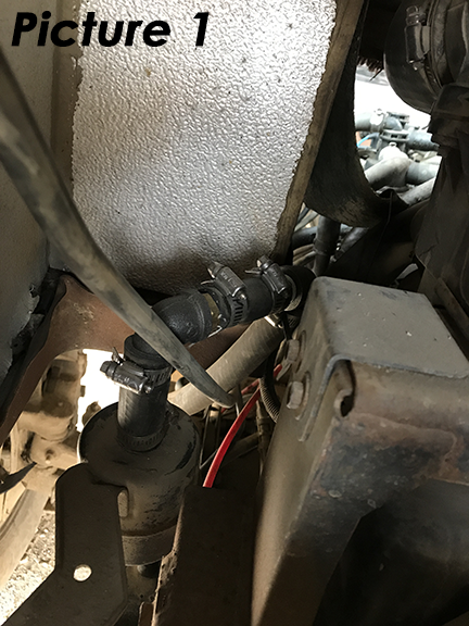

Three weeks ago, we installed an electric vacuum pump to run our Dash AC as quite often while going up a hill, we would lose vacuum and the AC would start coming out of the Defrost vents, which is quite annoying when it is hot out. While we were repairing that, we noticed quite a large hose that was kinked. We assumed it shouldn’t have been kinked so we reworked the hose with some elbows to allow it to breathe (see picture 1).

We found a vacuum line (see picture 2) which was rotting on the outside and was quite plugged on the inside. We replaced that, which also made a slight improvement.

I can't tell what the item is in the photos, but from the majority of the codes listed either the 5 volt reference voltage supplied by the computer is absent or a shorted path is pulling down the voltage to the various sensors.
