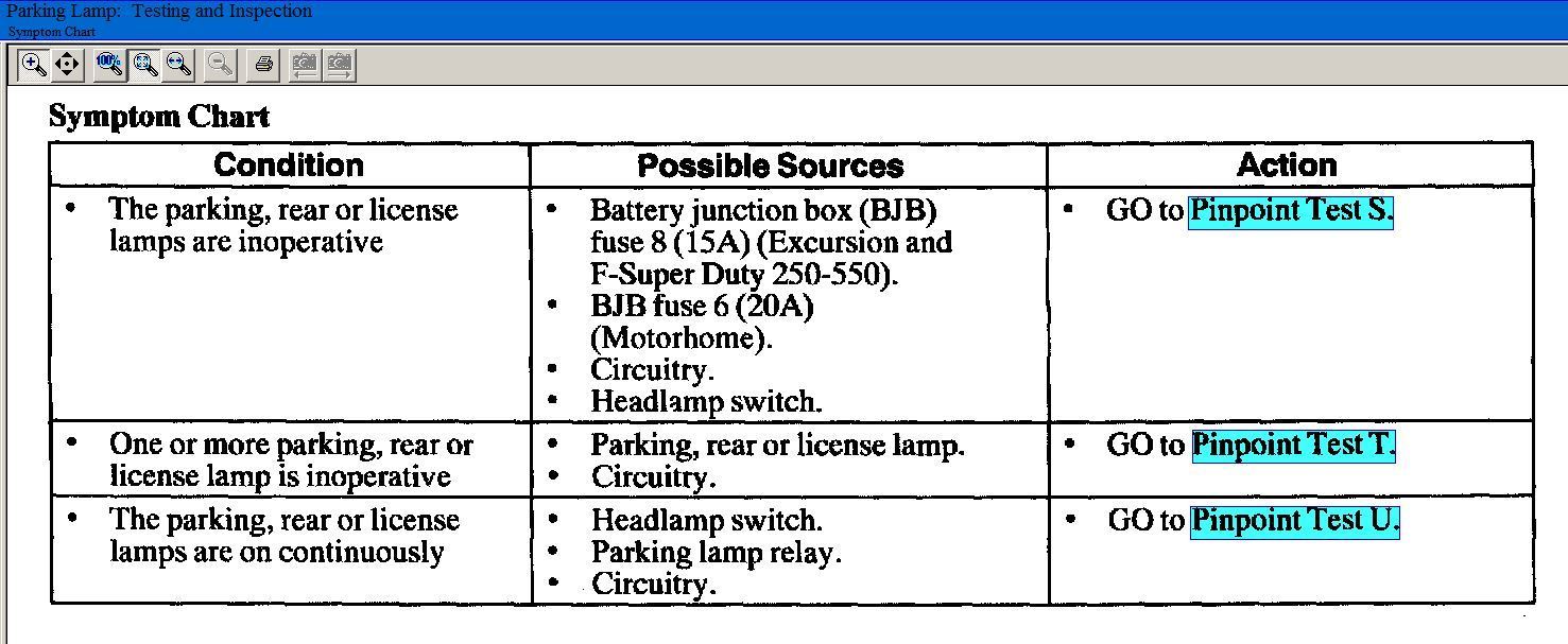

Rear running light (tail light), to be more specific, the rear parking lights including license lamp which you never mentioned whether or not it's working, and then it's also assume to be w/o blinker w/o reverse w/o brake.
You can go over the symptom chart above. Pinpoint S and T attached below.

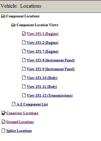

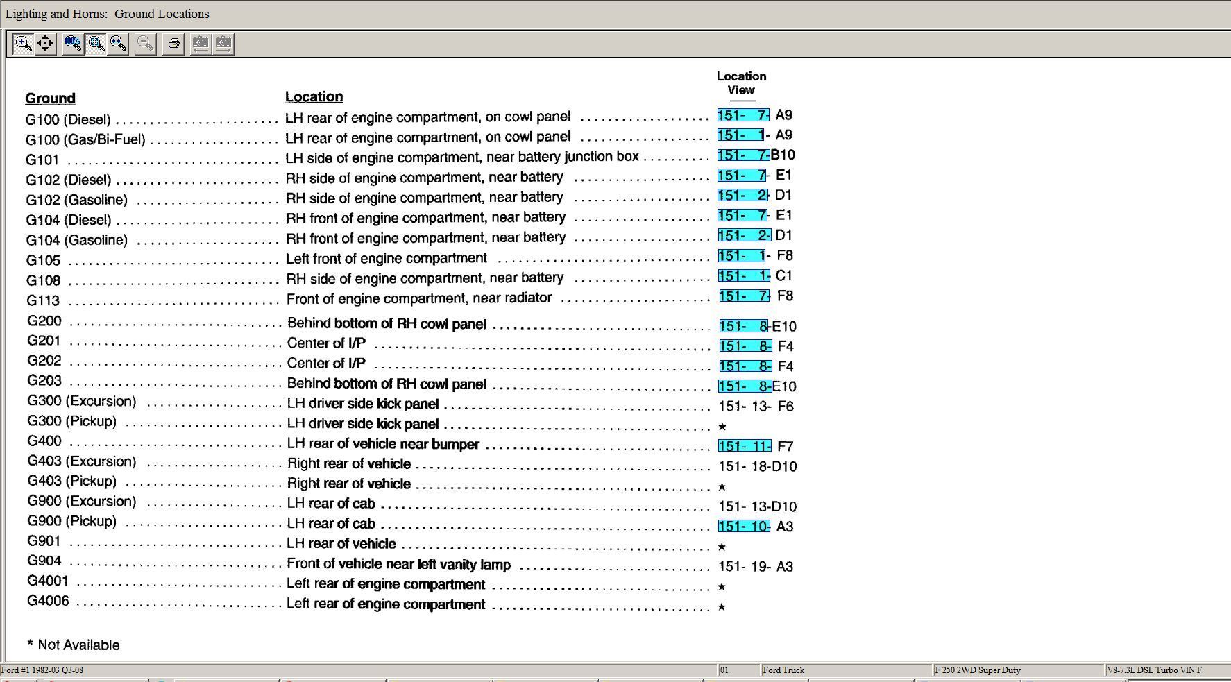

Above shows you the ground locations you are interested, on the right shows you the location diagram, for example 151-7. This is just a picture without the clickable link. To see 151-7 check ALL-Location.pdf attached below, it covers all locations of your whole van. Below is the index page of ALL-Location.pdf:
