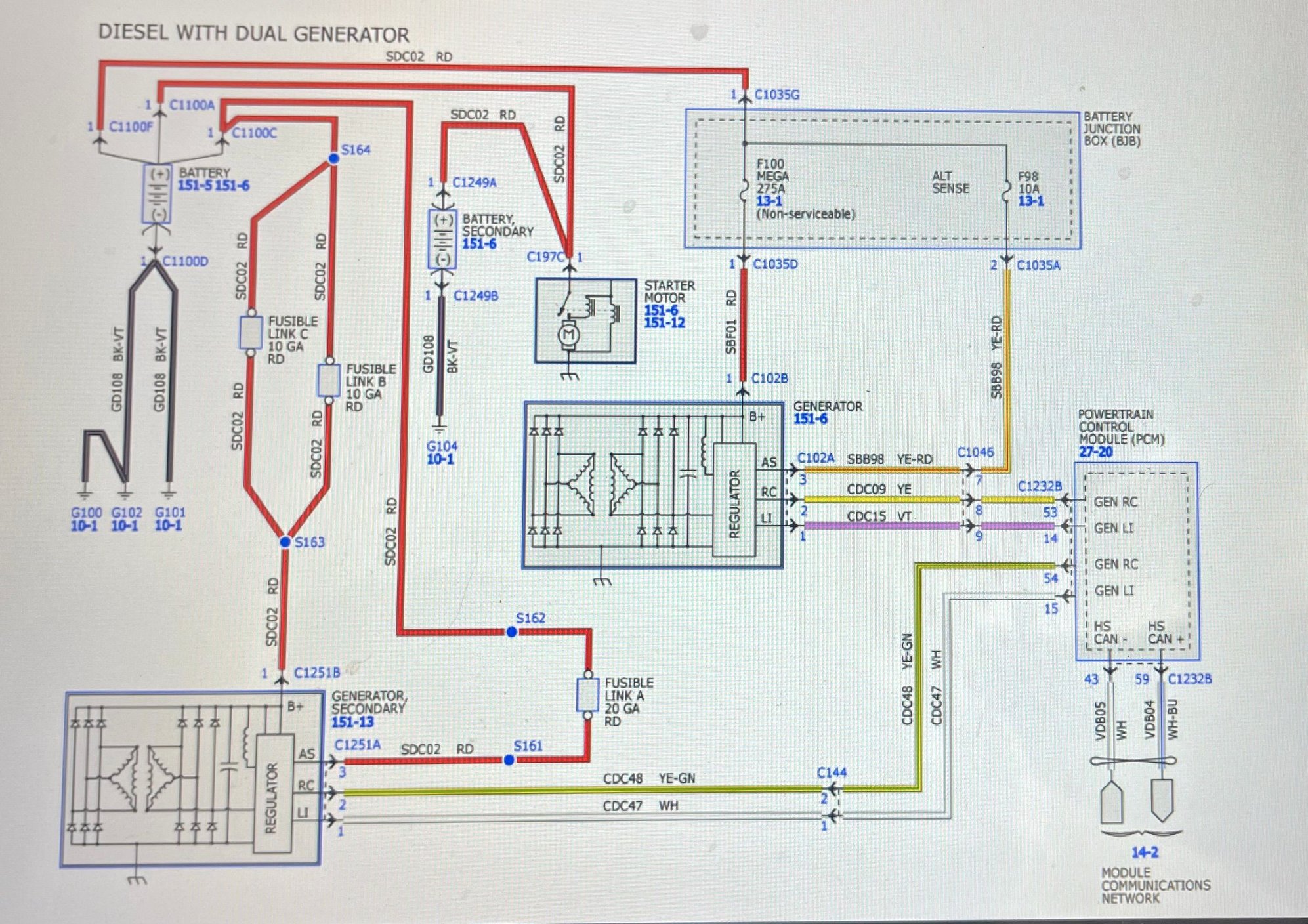

Can anyone with access to PTS or ALLDATA supply an image of the charging system schematic for a 2017 F250 6.7 (dual alts) ?

Can you pull up the one available and maybe we can get some idea of approx how it is wired ?

No worries, I had a P163C (Service Charging System Soon) code come up, but the odd thing is it appeared twice only as I tried to delete an active trailer from my towing menu.Everything is working/charging fine still , but these SD trucks had alt connector and harness issues that quite often was the cause. Just want to get ahead of it should a problem arise. Manager is on it, hopefully access with be restored soon.
Old Dec 15, 2024 | 11:55 AM
In case anyone finds a need.
