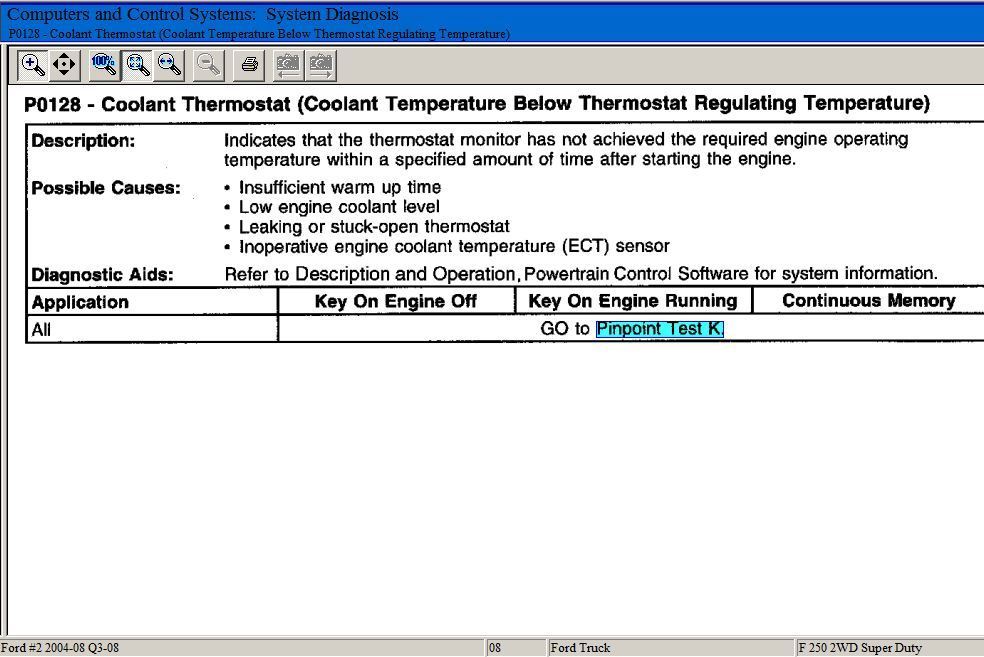

Very first thing check coolant level, then check for leaks.
Your heater working fine or not before you got the P0128 code?
Fully warm up your truck then use your scanner and check the ECT, what temperature you get now.
Is there a heater control valve on your truck?
Put your hand on the heater box (below passenger glove box) and feel it, now fully warm up then turn your heater to max and wait a few minutes, put your hand on the heater box again does it get warmer than before?
Do you have single or dual zone climate control system?
If you think you can handle to reverse the upper and lower hose before the firewall?
You should be more concern on your cooling system than your heater. Check 2 pdf below too.
